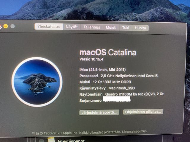

hello everyone, has anyone had any random reset problems? I am using a flashed k1100m, in catalina 15.4, any post about this?

What kind of shut down are we talking about? Does it have the "do not proceed" 🚫 logo, or does it kernel panic and reboot. Usually with the 🚫 the machine will shutdown after 30 seconds. This means that the platformsupport.plist needs to be manipulated again for the iMac to boot again. The dosdude1 Post install App can fix this.
Catalina installer crash (kernel panic) Once Installation goes ok, but I get panics very often. I try to reinstall it and installer crash. Sometimes when you do disk partition sometimes installer language selector.
Mojave seems to work fine, but then I get panics also there. Every 10-15 minutes it restart again.
It not seems to be hardware problem because High Sierra work fine. I have run test 3 days now and no issues.

I see you have a 21.5" iMac what size MXM card did you fit into your iMac?
MXM-A
NVIDIA QUADRO K1100M N15P-Q1 2GB
Okay, that is a Proper MXM-A card, but your issue is strikingly similar to my 2011 21.5" iMac when it had the incorrect (test) MXM-B card installed. The issue could be from Too many drives installed into your iMac, or a weak power supply. My issues were Reboots when setting up a New User account at the Welcome screen. Shuffling through iTunes Songs Quickly and downloading large files using Safari. Basically the MXM card draws power from the same rails as your drives do and doing something with a large power draw will cause these panics. Do you have a 3.5" HDD in your iMac still? This is drawing the needed 12V your MXM card also needs. I suggest removing (unplugging) it for the time being to help diagnose this issue. If this helps, try swapping it for a 1TB ssd as this will only draw 5V instead of 12v.
Eventually the real issue here is your power supply. I swapped mine with one from my 2010 Model iMac which helped a bit, but removing the improper MXM-B card from my iMac was my solution. I think removing the HDD from your iMac will be yours.
Reactions: nikey22 and 0607557
