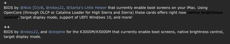

The difference between ++ and + is mentioned just below the table. The advantage or difference of the (765,770) 780+ vBIOS is mentioned in the particular post (follow the link and read!).

My only confusion is that the description explicitly says all ++ cards. And my choice being a K1100M, is a + card, not a ++ one. My educated guess is, the same still applies to the K1100M, regardless of it NOT BEING a ++ card.
The + cards need OpenCore to enable brightness control anyway. Usually users will install OCLP and get the solution this way. I have just mentioned the solution for people brave enough to use their own OC config or users sticking with the original Catalina Loader and 0.5.9 OC version.
My confusion is related to what I have read on the table:
BIOS by @nikey22, and @stephle for the K3000M/K5000M that currently enable boot screens, native brightness control, target display mode.
What the read text mean? It can be used ONLY on K3000M / K5000M or also on the 780M?
I follow the link and the ++ version report a 780M but my doubt remain.
Maybe should be removed the red text to avoid confusion?

This is just a list mentioning the fact that @stephle published the vBIOS versions for K3000M/K5000M while @nikey22 is responsible for all other achievements. ++ means native brightness without OC.
