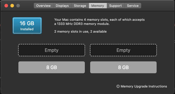

I probably was not clear enough on that - I have 2x8GB sticks giving 16GB total, not 1x16GB stick.
They are the OWC 16GB(2x8GB) kit - https://eshop.macsales.com/item/OWC/1333DDR3S16P/
