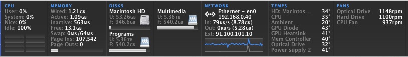

14 °C ambient ? Where do you live ? 😀
😀 In my bedroom 😀
I don't know why it displays 14 °C , i've got the air conditioning set to 22 °C and my "normal thermometer" (not hardware-software, only the beauty red and analogic mercury line 😀 ) show 20 °C .
Are absolutely not 14 °C in my bedroom 😱 I've noted that when the mac is hot also the ambient T rise… but the thermometer no 😀 so I think the imac sensor is too near the alluminium case, and when the mac is hot the temps rise, when is not hot the alluminium is cold and temps are (too) low.

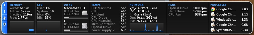

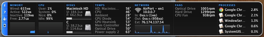

There was a recent power outtage when my computer was on. Ever since my iMac has been running extremely hot, especially the HD (50-55 celsius at 99% idle). I've reset the PRAM, repaired permissions, and checked activity monitor for any programs that might be taking up resources. Does anyone have any clue as to why this is happening? It was running fine up until 2 days ago. Any advice is appreciated. Thanks.
Your HDD is not hot KasperH. I have same temperatures as thebends6. I think we have different brands of HDD.

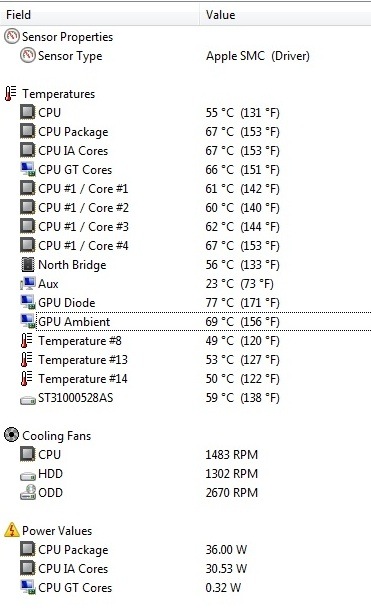

Here are the temps for my machine:
27”, i5 3.1 GHz, 6970M 2GB, 1000GB Seagate (ST31000528AS) HDD, 12 GB DDR3-RAM
Idle temperatures: Ambient: 19 — HDD: 46 — CPU: 38 — GPU Diode: 51 — GPU-Heat-sink: 47 — Memory Controller: 42 — Optical Drive: 36
Idle fans: CPU: 998 RPM — Hard Drive: 1099 RPM — Optical Drive: 938 RPM
Load temperatures: Ambient: 23 — HDD: 59 — CPU: 55 — GPU Diode: 77 — GPU-Heat-sink: 69 — Memory Controller: 56 — Optical Drive: ??
Load fans: CPU: 1483 RPM — Hard Drive: 1302 RPM — Optical Drive: 2670 RPM

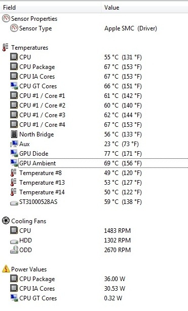

Since I don't have that many demanding Mac apps yet I decided to fire up Bad Company 2 on Bootcamp for max temps. (Gaming on this machine is a blast after all.)
Aida64 found a bunch of additional sensors, so I'm not that sure what's the equivalent to the "Ambient" and the "Memory Controller" sensors displayed in iStat. I added the screenshot below. I guess the Aux-Sensor is synonomical to the Ambient sensor but no idea about the memory controller. Any ideas?

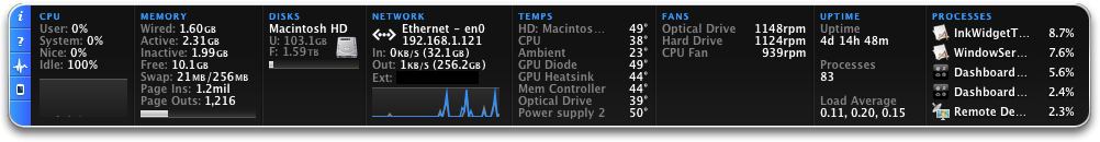

My speeds are:
- Optical Drive 3435rpm
- Hard Drive 3495rpm
- CPU Fan 941rpm
There is a fairly audible noise level from the fans still, and I'm thinking the first two numbers aren't normal. SMC was added instantly via Time Machine but have removed it and still no slowing down or quietening of the fans.
Can anyone verify if this is normal speeds? I've had my iMac [27" i7 16GB RAM] for 24 hours roughly. 😕

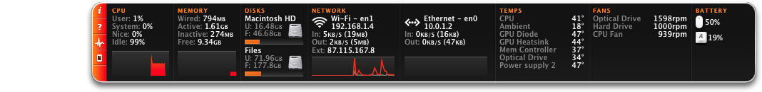

Does anyone know a way to reduce the Optical Disk Drive speed on an iMac?
It runs at a constant 1600rpm and from looking around the internet and in the forums it should be nearer 1100 (ish) It is starting to bother me now as my iMac used to be silent 🙁
I fixed it myself 🙂
Download SMC and forced it to 1000rpm. Peace and quite at last.

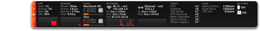

I fixed it myself 🙂
