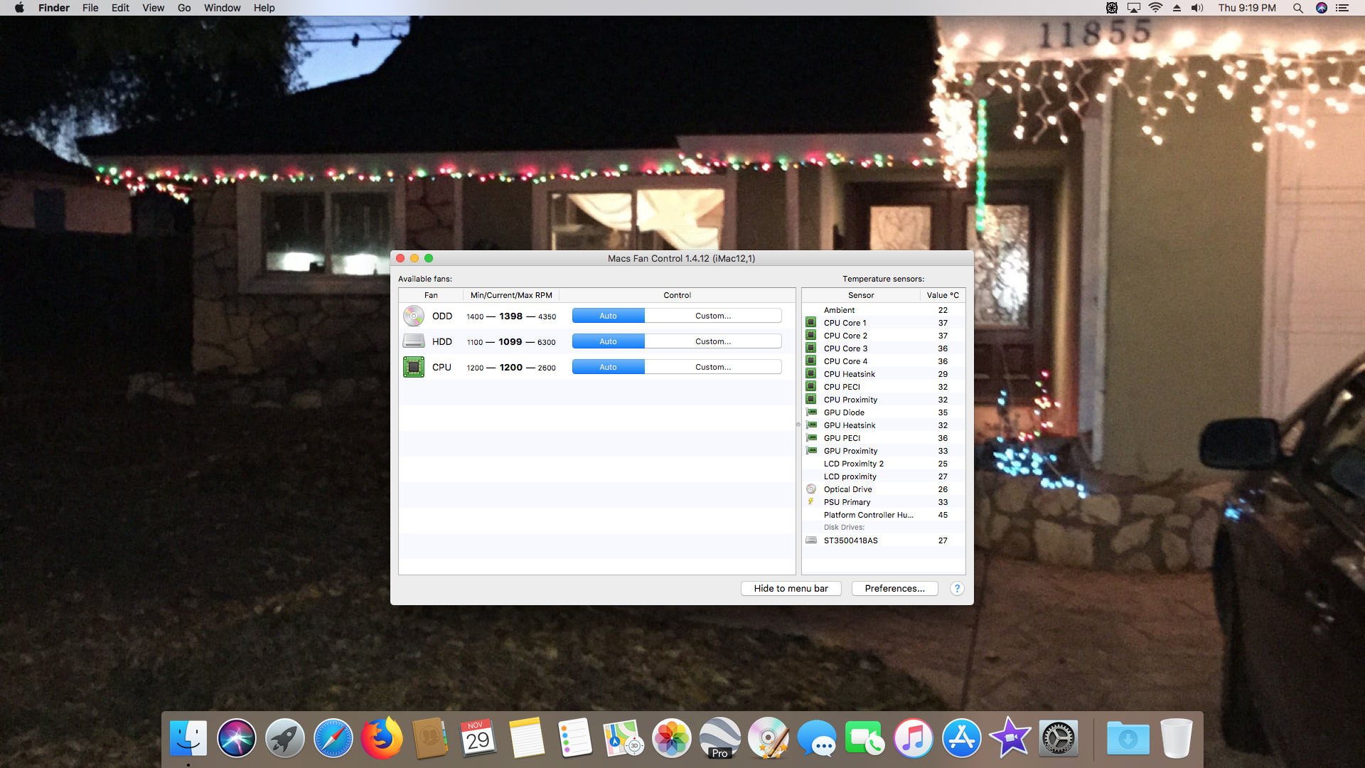

what are yout temperatures saying .. ?
post a screenshot here from macsfancontrol program.
2011 imac's are known to get very hot AMD GPU's !!

Here it is
Gary
these iddle temps. look fine to me.

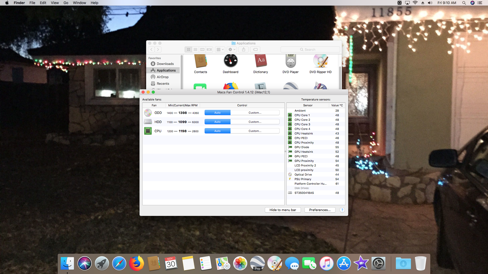

post them new temp. screenshot, after watching a movie for example or doing something intensive with your mac..
Watching an h.264 video shouldn’t stress such a Mac much, assuming your software is doing proper hardware h.264 acceleration. If your software isn’t doing proper hardware h.264 decode acceleration then it’s time for new software. You’re out of luck though if it is h.265 HEVC video, since these machines do not support hardware h.265 acceleration.
