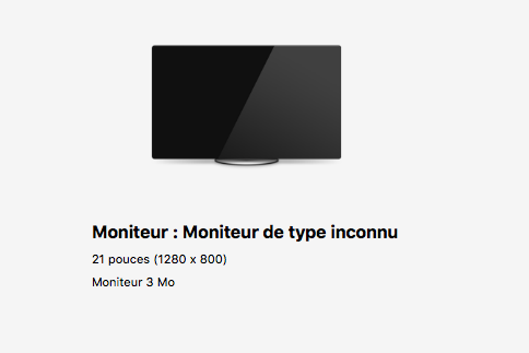

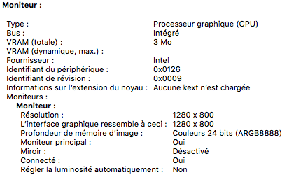

Hello guys! I really hope someone can help we with this, I install the three kext a few weeks ago and it works perfectly until now. I don't now how this happened... I tried installing x code using a tutorial from internet ton download an older version. This worked well but then I rebooted my computer and now the graphics are terrible and as you can see it doesn't recognize my Intel HD Graphics 3000 anymore ...
I tried resetting the VRAM with alt+shift+R+P also went to check the hardware apple test nothing wrong ... I also tried to reinstall the kext because i thought this could be the problem! I am really lost here and would be a millions times grateful to anyone with a solution for this!
My computer opens the monitor tab in the top of the screen and says there is a unrecognised monitor
Here are some screenshots of my specs of my macbook its in french but there is a line that says
"Information on the extensions of the center : No kext charged"
helllp

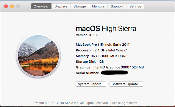

Hi Guys!
The intel HD3000 kext mods work on macOS 10.13.6 to get 1024mb of Vram.:apple:😉😍
1- first disable SIP
2- reboot
3- download AttachFiles
4- Run Kext utility App
5- Just Drag Kext Mods files to kext utility app
Enjoy!

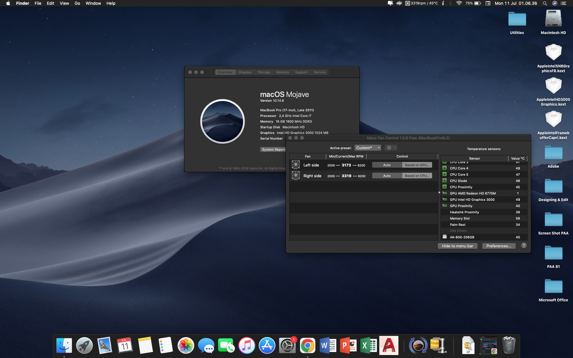

Hi, I come to update.. This kext also work on MacOS Mojave. I thought could work. And it actually work.
I'm tried to figure the best configuration for my 2011 17" MBP, without doing any desoldering to hardware, and do the software tweak instead. High Sierra is the native supported OS - and the kext work with it, but when the dGPU disabled, for me the tweak do get brightness control work is too hard and confusing.
So I think this is the best configuration (at least for me). Install the Mojave, disable dGPU, and tweak the kext, without doing desoldering or typing in terminal.
