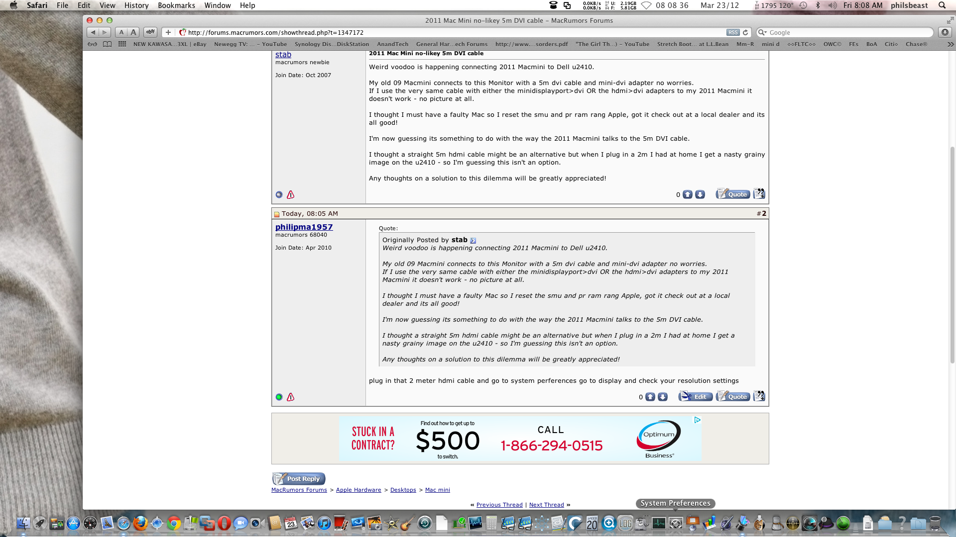

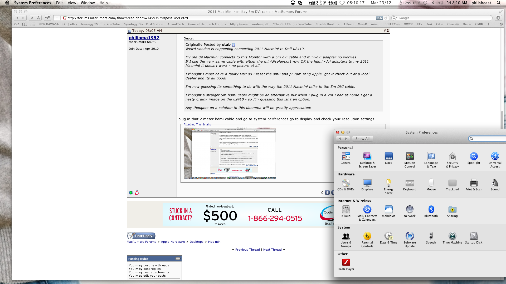

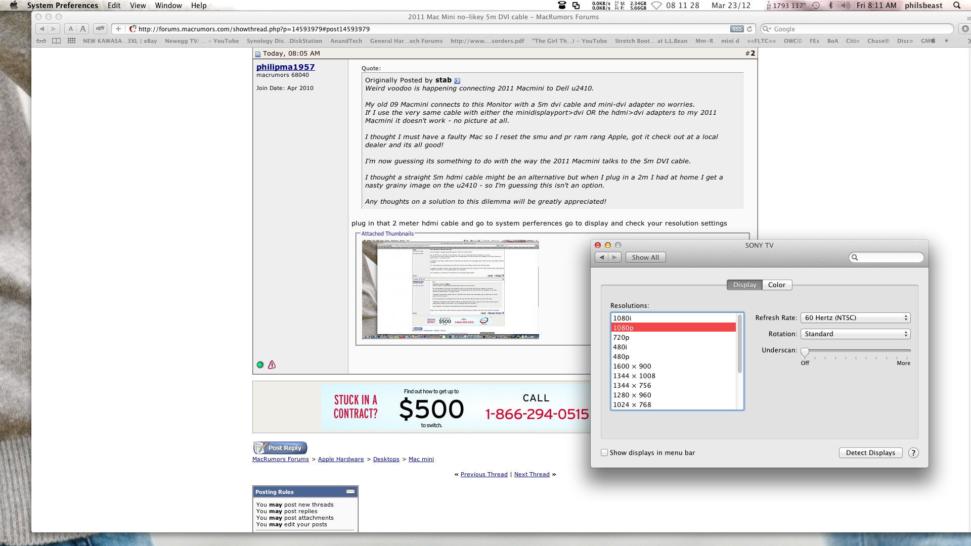

plug in that 2 meter hdmi cable and go to system perferences go to displays and check your resolution settings. I have a sony tv as a monitor so 1080p is the best setting for me. in your case 1920 by 1080 may be the choice. I am guessing the grainy picture means you are set on 800 by 600 or some other low resolution
So getting a 5m hdmi to dvi might be the go. Going to the monitor settings was the first thing I did - I tried every possible display setting change both on the mini and the monitor with every cable combination and it made no difference; couldn't see a damn thing. hdmi to hdmi seems to only work with TVs; reading from other forums it seems that the macmini assumes that doing this means you are plugging into a tv and it adjusts some setting to make this happen (and it was confirmed when I went to system profiler where under displays it says Television).
