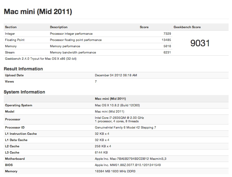

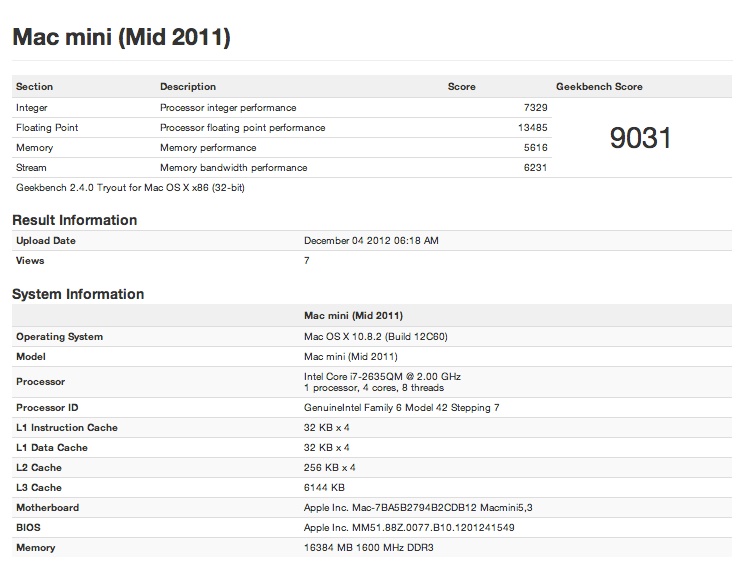

Ran Geekbench, but only 32 bit, and speeds got a bit better (from 8950 for 8gb to 9013-9031 for 16gb). I didn't do the Cinebench for the 8gb setup, but for the 16gb setup, it came out to 4.44 for the CPU, and 11.54 for the Open GL.

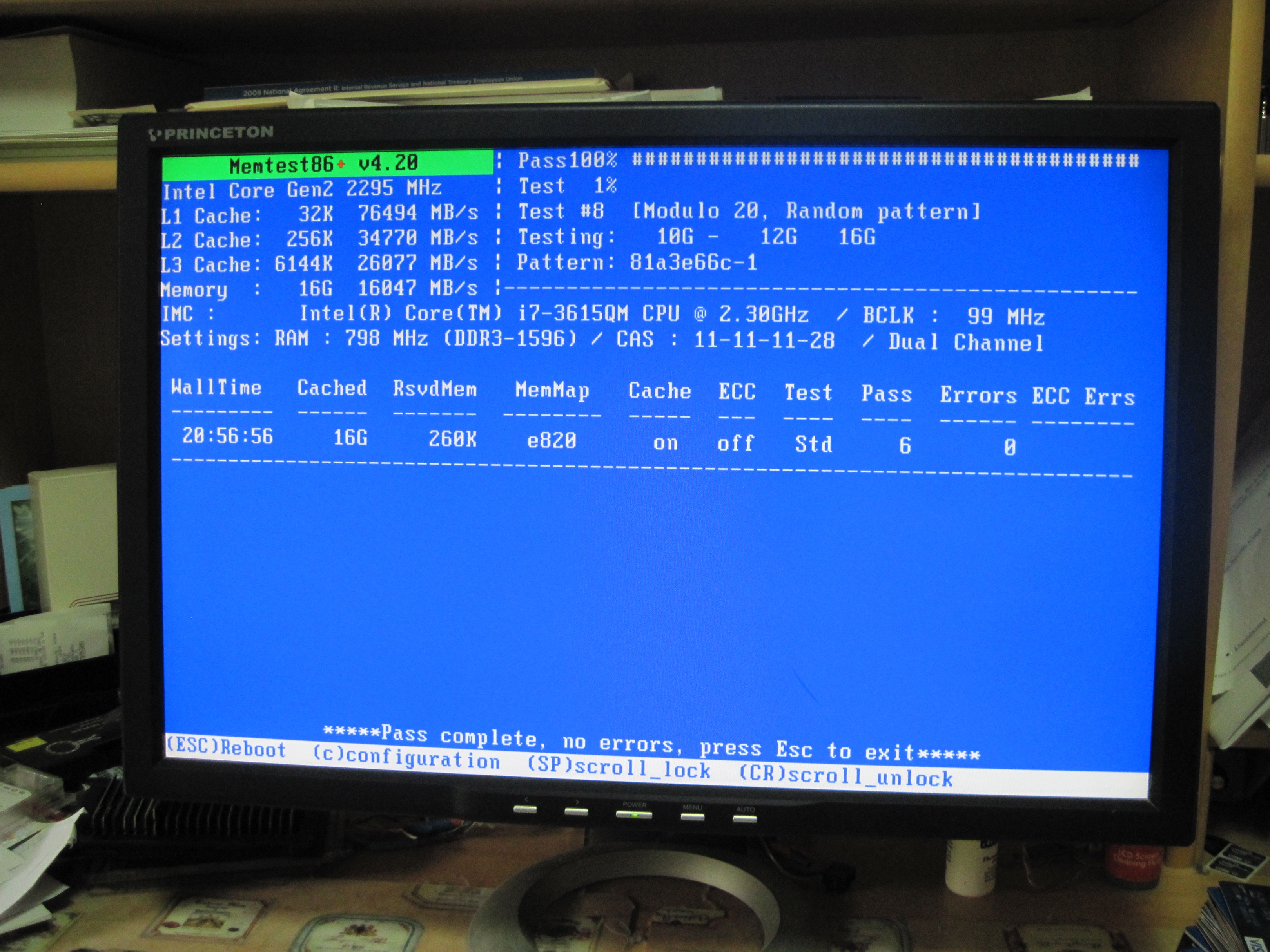

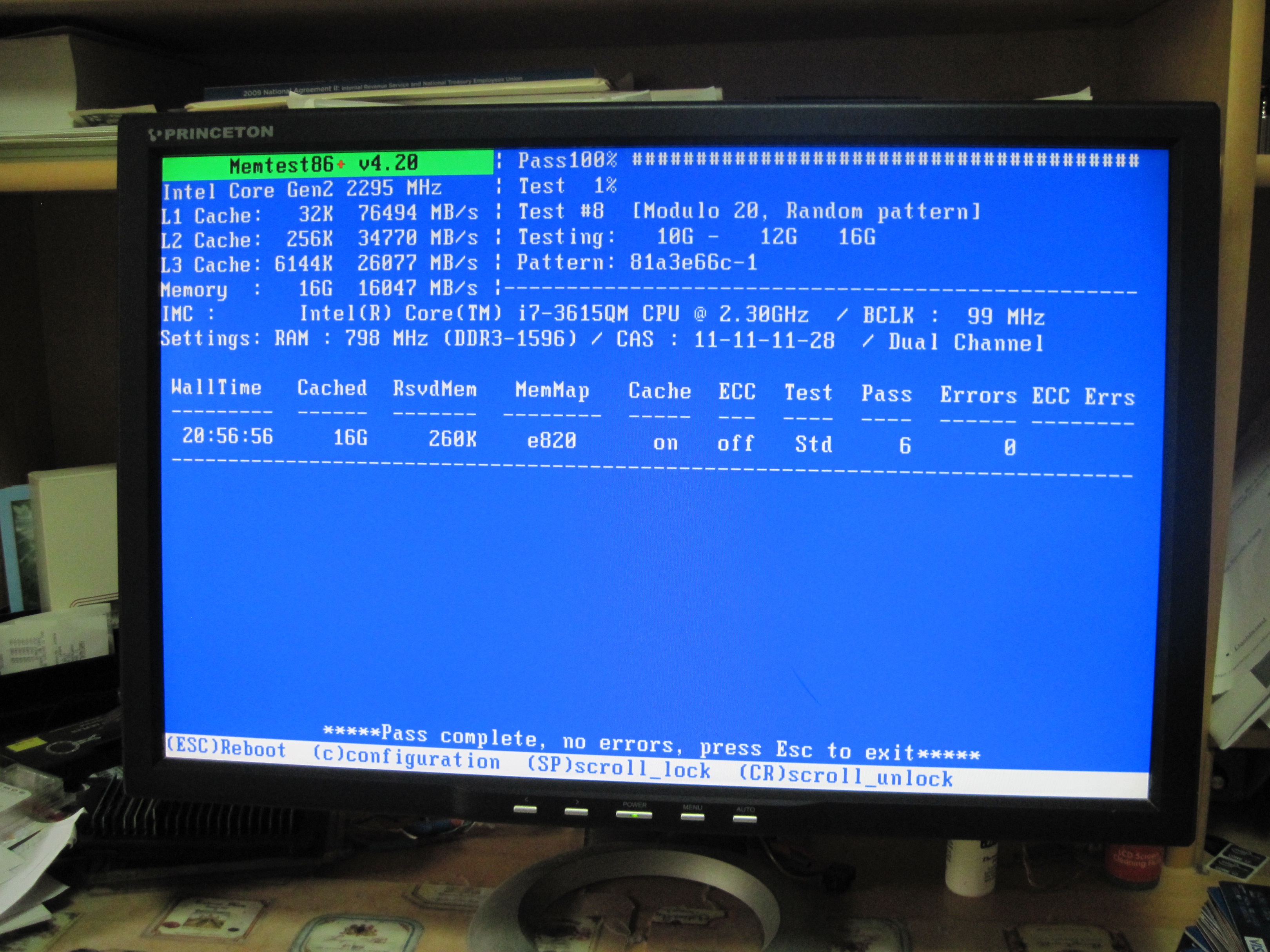

it is a bit more complicated. the best way is to download memtest86+
http://www.memtest.org/
burn a cd and boot directly into it
you get a blue screen . this test was from a quad 2012 mini with 16gb crucial ram
it reads half what you run at. my crucial reads at 798 which is 1596. this tests runs all the ram rember runs around 13 gb out of 16gb. remeber ram test is based on memtest.

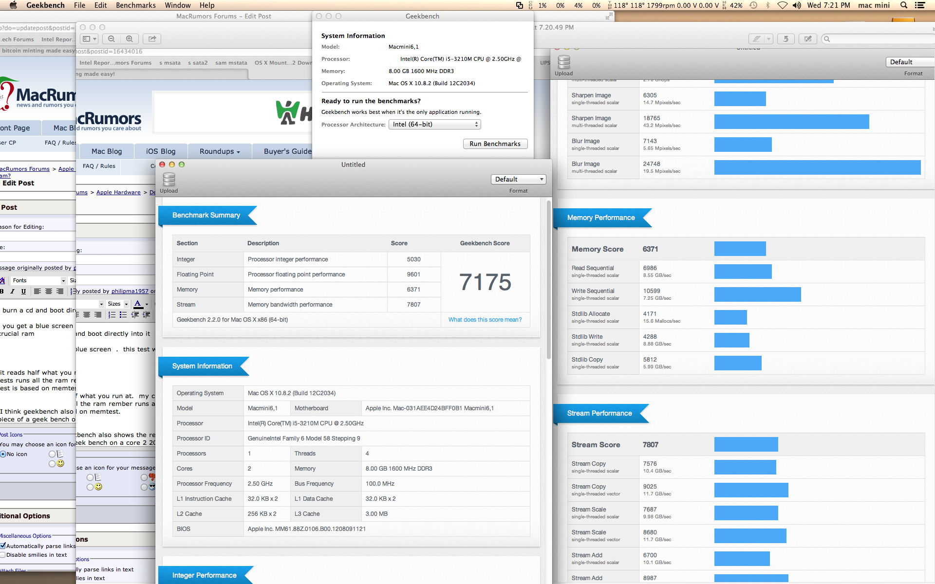

I think geekbench also shows the real speed. I will run a test. here is a piece of a geek bench on a core 2 2012 mini with 8gb 1600 ram.
if you were to run the same mini with 2x 4g sticks of 1333 ram the geekbench scores would change. this tests will show differences but in real world 8gb of 1333 ram or 8gb of 1600 ram in a 2012 mac mini would be very hard to know a speed difference.

Your geekbench scores are so wildly different than mine. I see you have a different year, different processor and 1/2 the ram. Does it make sense that your memory scores are so much higher than mine, considering that I have twice the ram? (Or are all the differences related to the fact that I used the 32 bit geekbench?)

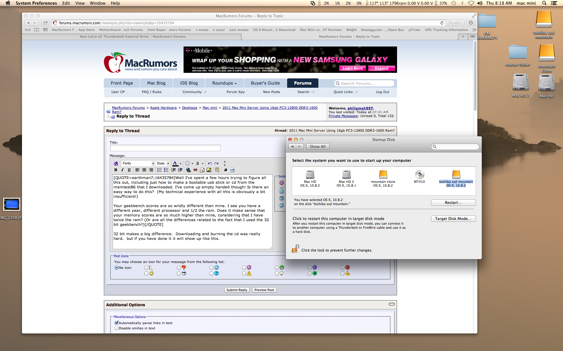

32 bit makes a big difference. Downloading and burning the cd was really hard. but if you have done it it will show up like this.
the mt410 is it. I have a macbookair cd player and all I need do is pick the mt410 as a boot option. it then boots into the blue screen.

Yeah, "hard" is what I found too. I'll try again when I get some time before I have to choose whether to install this ram in my 2011 or in my friend's 2012. You'd think it would be a piece of cake to create a bootable disc from a disc image... I know I've done that several times in the past!

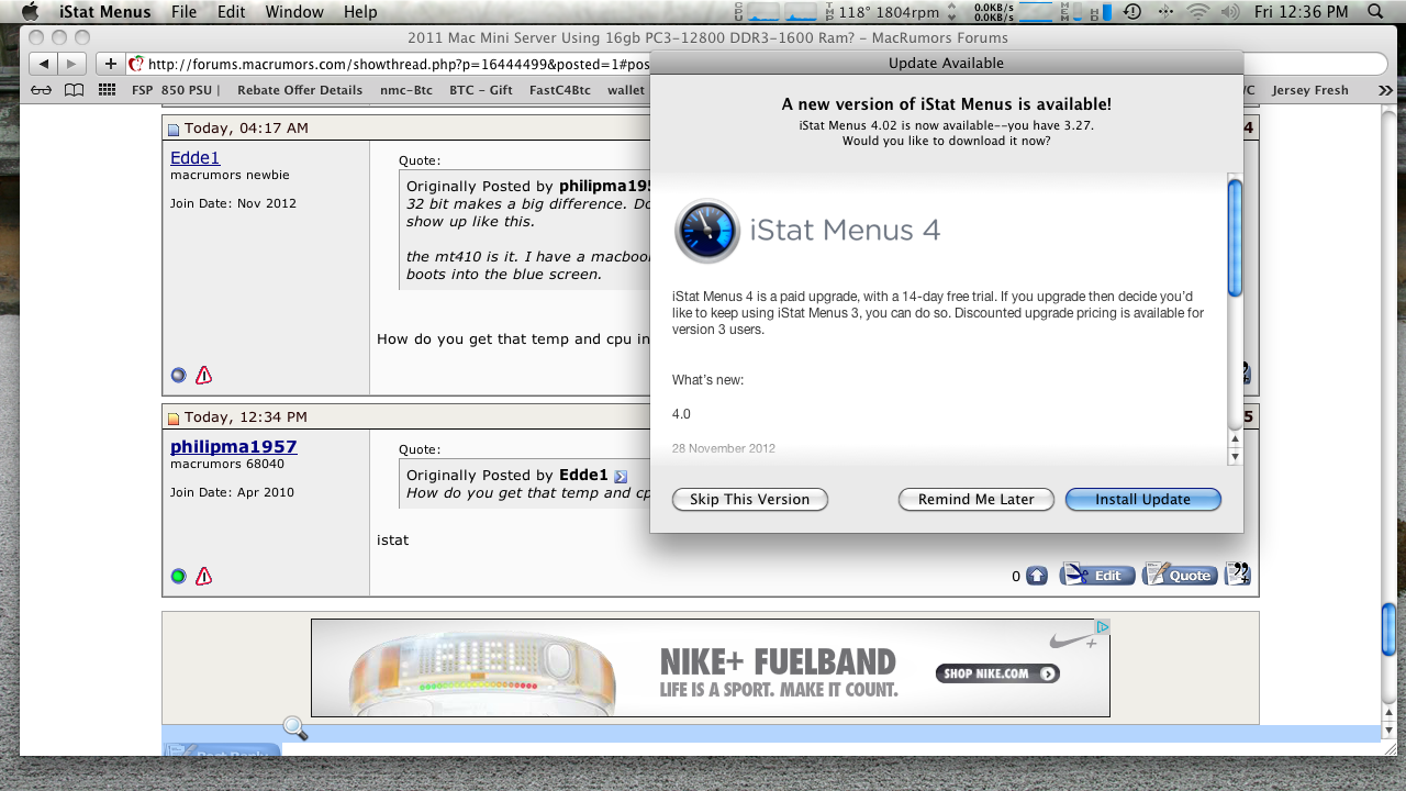

How do you get that temp and cpu info on the top of screen?
