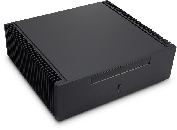

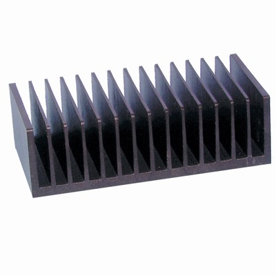

You may want to add some heatsinks to the sides and attach them with thermal transfer tape (no drilling required).
You'll have to hunt around for the correct lenght of heatsink and may have to cut it to the right height. I've done this in the past using a normal tungsten tipped mitre saw. (make sure to clamp it properly and never just hold it - you may loose your hand)

Bright aluminium does not radiate / absorb much heat. The external fan proves that the internal cooling is inadequate.
ROFL. That's awesome.
