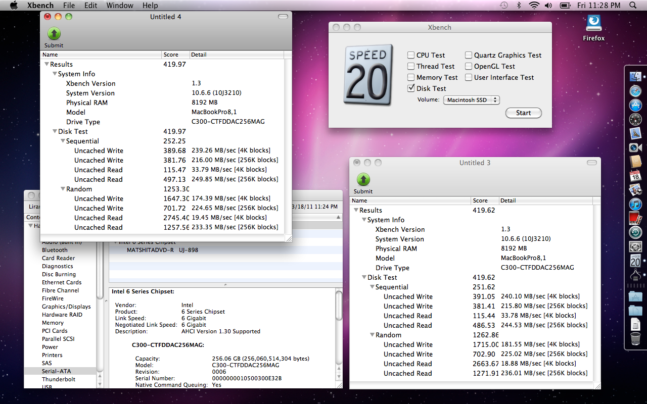

Okay, some results.. I apologize ahead of time for the large screenshots.
First up, 2011 MBP 13in 2.7 i7, 8GB Crucial 1333, Crucial 256GB C300 SSD.
fyi: clean install, nothing installed except firefox.

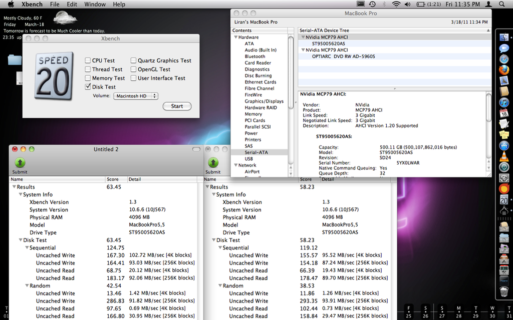

For comparison, late 2009 MBP 13, 2.53 C2D, 4GB 1033, STX Momentus XT 500GB Hybrid.
fyi: OS cloned from previous HDD, so not fresh..Also ~200GB free.
From cold start, the SSD machine is usable before the XT even loads the apple on the white screen.

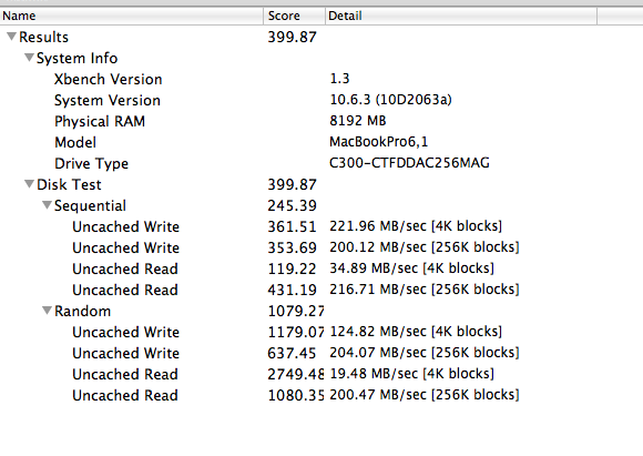

I put a 256gb c300 in my 2010 17" MBP. Looks like mine is a bit slower than yours, probably due to sata2 vs sata3.

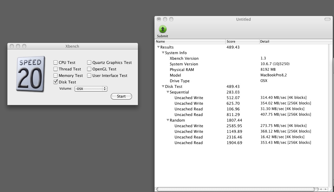

I bought a 2011 13" MBP Core i7. I've got a C300 256GB SSD which I pulled from my previous MBP. It worked a dream in my 2.53GHz 13" MBP.
I imaged the stock 500GB drive to the SSD and swapped it out. Everything appeared ok, booted up fast and logged in fine. After about 5 minutes uptime, the fans started running at full speed and process usage topped out at 190+%. I managed to install iStat and monitor processor using from the menu bar and could see syslogd was hogging the processor for some reason. Then shortly after that any apps running just beachballed. Force Quit failed to work, so pretty much stuffed. In the five minute window before it started going haywire, I stopped Spotlight from indexing as I could see if was trying to just to see if that could be causing the issue with increased disk reading. It seemed to help a bit but can't be 100%. It just prolonged the time until is froze.
I decided to wipe the SSD and try a clean install from the recovery disks just to see if that would solve the problem. Unfortunately, OS X fails to install. The SSD was formated with a single partition and labeled 'Macintosh HD'. Checking the installer logs, it was having trouble writing packages to the SSD.
