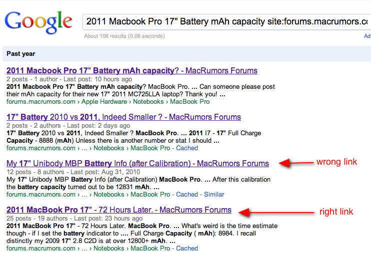

I will cheerfully concede one major mistake I made. I knew this topic about the difference in capacity had been discussed and when I searched for the thread I had seen, I copied the wrong link from the search results. As it turns out, the link I intended to copy was a thread that you posted, and it was the very next link in the search results:
2011 MacBook Pro 17" - 72 Hours Later.
