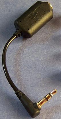

As stated by MANY people, it really is most likely the 'impedance imbalance' that causes this.. Too Low = Too Loud, or more accurately it is trying to be.. ** To Confirm: Do you find that the headphones (often In Ear models) are quite LOUD with the MBP Volume Set on seemingly LOW, quite possibly the last Level before OFF..?? ** If so, continue on here.. 😉
I work in the Pro Audio Industry and often with artists who use In Ear Monitor systems to hear themselves on stage.. many of these 'headphones' are custom-made and of quite Low Impedance (very sensitive) and as such are easier to be made LOUD On-Stage, and as a result they ALL will appear to sound noisy in a MBP.. :apple:
A simple solution is an Attenuator piece that is included with some manufacturers called an 'Airline Adapter Kit' as airplanes also have notoriously HOT Amplifiers, to power CHEAP inefficient headphones to a reasonable level.. it is a simple 1/8" TRS (Tip-Ring-Sleeve) in-out piece that has a Resistance built in (may be variable, as with the SHURE EA650 piece I'll show link to below) ~ When inserted, you will find that you can/will be able to Run Your Headphone Output to a much more reasonable mid-way Level, and the resultant 'noise floor ~ Hissing' will be rectified.. Most Likely..
That being said, if the above symptoms are NOT what your system shows, then THAT is not your issue.. and Good Luck may be involved!!
EA650 : http://www.shure.com/americas/produ...-headphones/earphone-headphone-cases-adapters
Ultimate Ears : http://imagehost.vendio.com/preview/a/3578944/view/ultimateearsairlineadapter.jpg
More on the discussion : http://www.head-fi.org/t/370991/ultimate-ears-airplane-adaptor-whats-it-do
