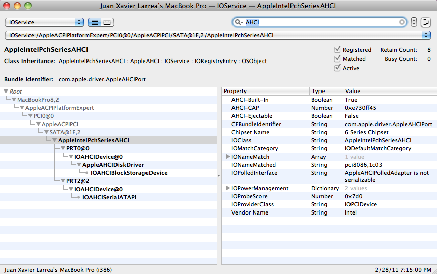

I'm starting to get slightly pissed at this as well... Not that I am entitled to a product entirely catered to my uses but I was hoping to put in the SSD into the HDD and SSD into the optical bay. Because of the SMS, it'll have to be flipped. Because of Apple (as of now), I lose SATA III performance in the optical bay. When I get a chance I'll go to my Apple store across the city, it's a retailer and since Koreans love Windows, it has some Macs running on Boot Camp 🙂
I had someone on another forum check the SATA port configuration on his 2011 MBP and it does not look good for 6Gbps from the ODD bay.
It looks like the HDD/SSD is connected to Port 0 and the Optical Drive is connected to Port 2. See IORegistryExplorer capture below for evidence.
that confirms it.
cue rage.
cue paranoia about sata port 'wearing out'.
that confirms it.
cue rage.
Yeah, I hate being the bearer of bad news. I'm still trying to find out an easy way to tell what stepping of the chipset is being used. It seems unlikely that they could have used the revised parts with such a short time between the recall and the new product launch. Stranger things have happened though...
No paranoia. It's already said by Apple that they don't use the faulty chipsets (although a proof on this by looking at the chipset revision would be nice).
As for rage. . . A Big ㅗ to Apple on this one. Damn. I know the optical drive wasn't intended to be used as an extra HDD bay but still, I r disappoint.
Ah Bullocks! This blows...
So now it's OFFICIALLY CONFIRMED:
MAIN DRIVE - SATA 6 Gigabit Capable (which is at Port 0)
OPTICAL DRIVE - ONLY SATA 3 Gigabit Capable (which is at Port 2)
