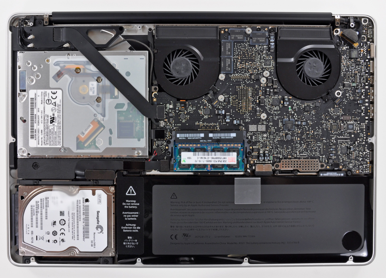

The black plastic stripping has come away at the back, peeling away, looks like it has slowly melted over the last decad, now exposing what appears to be circuitry? Need I be worried?
Pull the fan out completely?
Or just the bottom case?
Just clean out the fan and heatsink, should be no need to remove. You'll know more once the baseplate is removed. I have an air blower which works well. I also stabilise the fans so they dont overly spin up in the airflow of the blower (no metal tools in the case). If you want to go further use the guide from iFixit saves a lot of pain. As power is on as long as the battery is connected.
While mine is a 15" same production year. The fans on mine have some small foam seals that are starting to degrade. I replaced with some double sided foam tape.
Not very apparent in this picture, may have been a minor iteration by Apple as the Late 2011 15" were ferociously hot with the i7 and notorious for the dGPU failing due to heat stress. Mine's been apart for cleaning a good few times so never has too much build up of dust. Mostly I open it to check the battery is OK. Be wary of "tinned air" as the blast can damage the fan blades.
As for the strip I'd just stick it back on with as little adhesive as possible, Just in case need to remove. toothpick works well to apply as at times less is more.

My advice: remove the bottom case cover and use an air gun or can of air to blow out the fans. Keep the nozzle a few inches away from the device to prevent overdoing it. Blow into the round openings that you see the fans' impellers in (see the photo in Queen6's excellent post above) and, in the fan housings, blow "upward" (in the photo) to blow the dust, lint, etc., out of each fan's vent grille.
