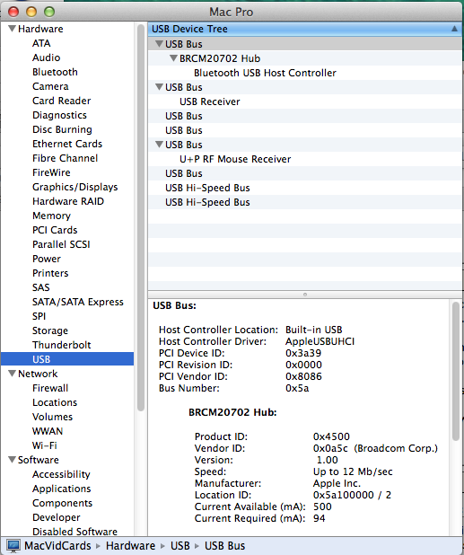

Look in post 271
Note the System Profiler window
Note that the poster has clicked on "Bluetooth"
Instead click on "USB" (further down the list.)
There should be an entry for BT as it is wired through USB bus

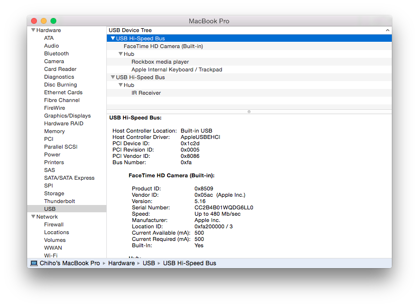

I don't have that one.
Wifi seems to work okay based on your screenshot.
