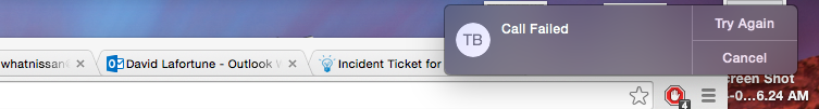

Every time I try to make a call from my mac it fails.. BUt yet i have continuity working.. WTF?

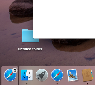

Let us know how it worked
It worked! Yay I can edit my own kexts now. 🙂
Phone relay and sms relay have both been delayed until october as far as I know. They know those features work, and removed them from the GM of iOS 8 as well as the most recent betas of OS X. It will be activated via an iOS 8 update alongside the release of Yosemite. If you remember to last year, they did a similar thing with iCloud Keychain where it disappeared in the iOS 7 GM and then was re-enabled when Mavericks was released.
