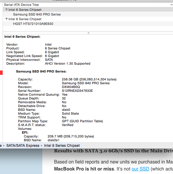

question does this mean that the logic board supported sata 3 in the optibay? if so this rules out the hd and firmware option and limits it to a failed drive or sata cable?
Yes. and Yes. All indications are the cable.

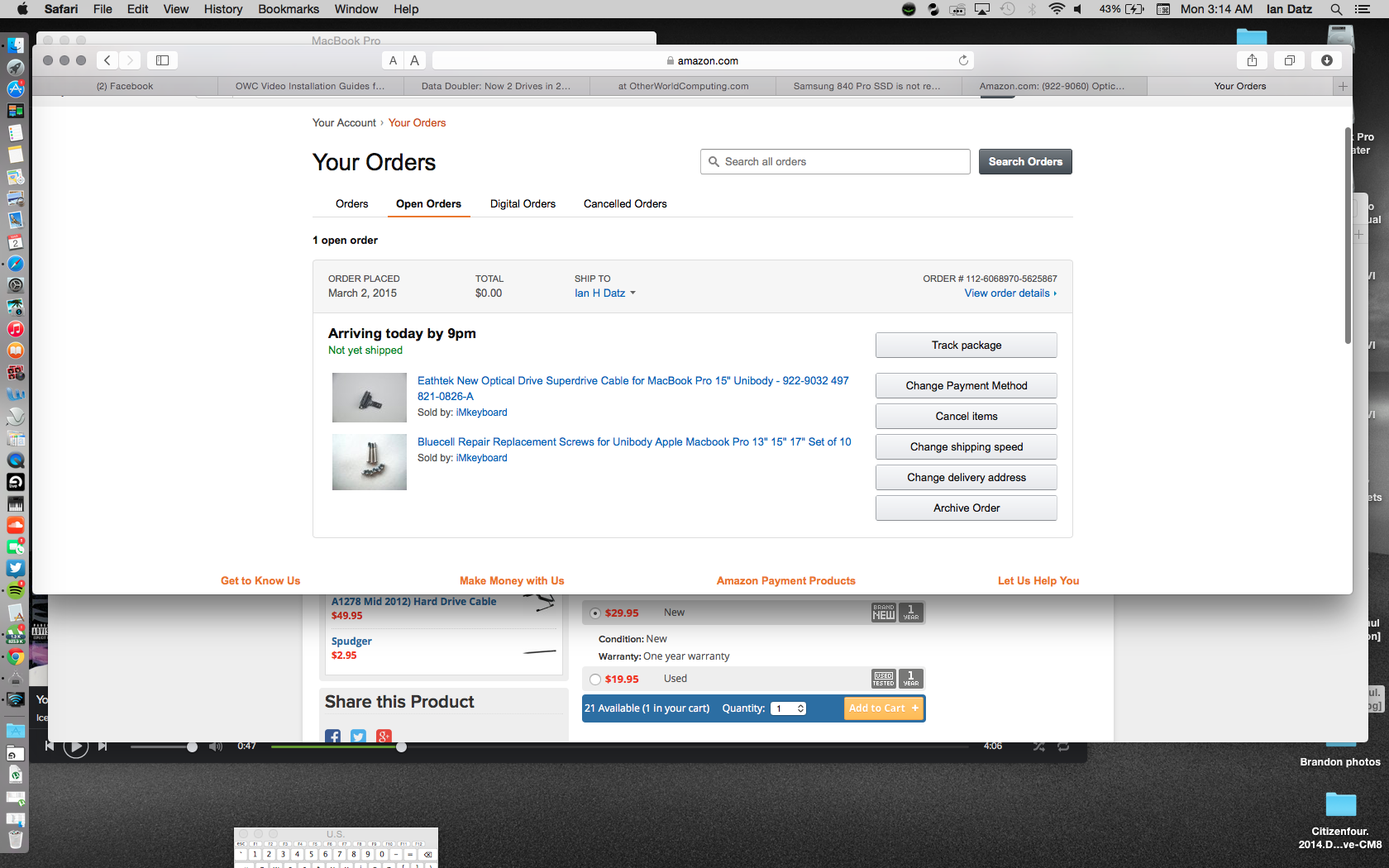

is this the cable i want to replace?
https://www.ifixit.com/Store/Mac/Ma...to-Mid-2012-SATA-SuperDrive-Cable/IF161-040-1
or do i need to replace the optibay data doubler which has a cable?

If I am correct there is no cable for the data doubler in the optibay. It is just the superdrives sata cable taken off. I had amazon credit and ordered this and it will arrive later today. Hoping to god this works if not i will try swapping the hard drives but i highly doubt the hard drive just died in the 2 days that apple had it.

So go with step 4, all working fine. Why not run with that - that is how I run. You can run System Info to see what speeds are being negotiated on both SATA ports.

If both drives are working then check they are working at SATA3 (mine do in the same locations), if they are then you don't need to do anything (except remove that screw).
