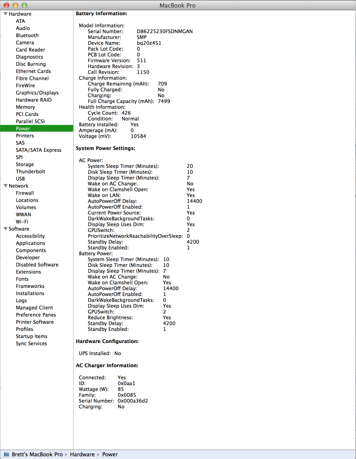

It says plugged in, not charging. Same in Windows through bootcamp. It will stay at 12% but will not charge.
I have reset the SMC and PRAM, cleaned the MagSafe on the computer and cord with rubbing alcohol and tried a different charger. Nothing seems to be helping. I really don't want to have to replace anything but I will if it's not risky/too expensive.

Yes It has held a good charge. It says the battery is in normal condition.

Red-orange (not amber) is an error in the charging circuit (and you already know that!) Often it's a problem with the adapter, but you have eliminated that. And, that leaves something internal, like the magsafe connector. If THAT doesn't fix it, then it's something else, like the logic board or the battery. The numbers that you already showed _probably_ means the battery itself is good.
