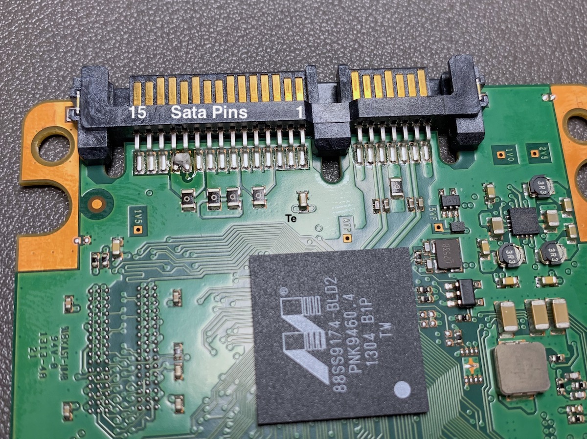

So I tried the hack at SSD pin level from this logi.wiki guide for 2009-2011, not 2012 but I gave it shot on a spare 128GB SSD.
Logi.Wiki
I shorted pins 12 and 11 - small piece of solder material cut and soldered. This hack did not work. I may try pin 11 and 10. To clarify, the SSD works as normal, but it did not address the fan speed issue.
