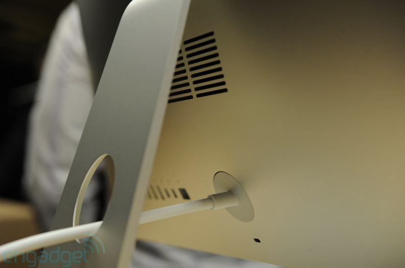

Kinda
this is where the heat leaves the machine:
