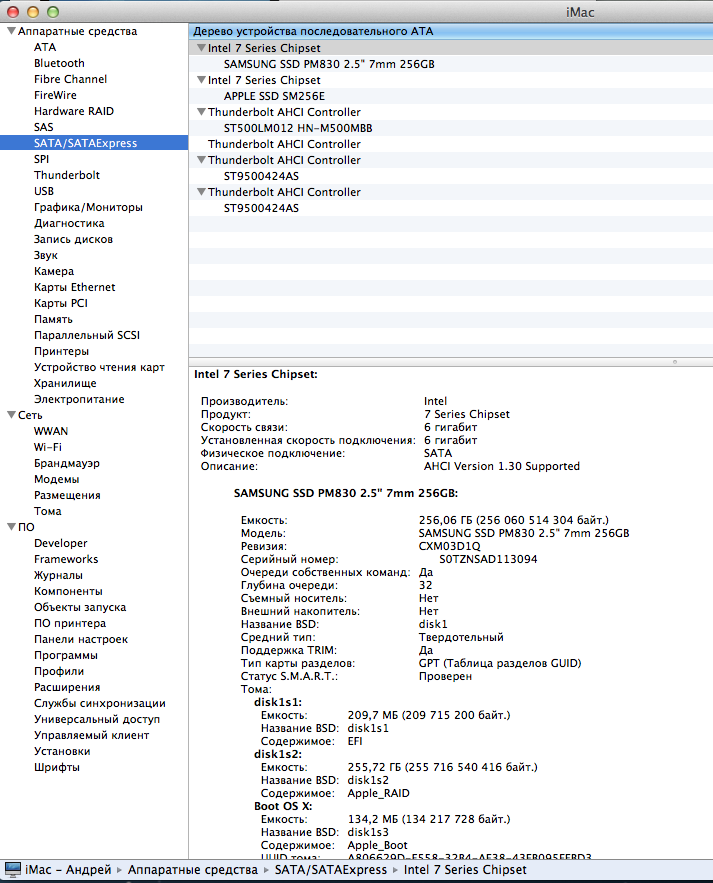

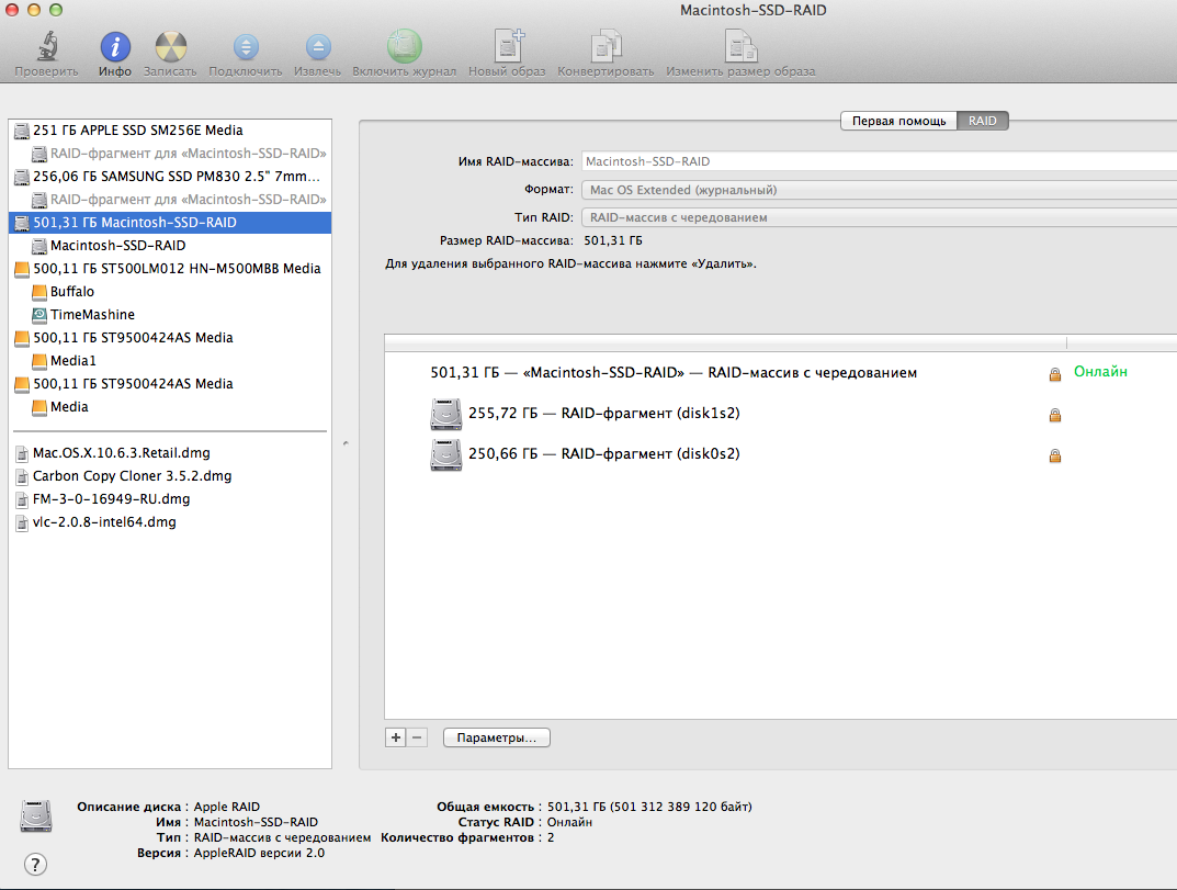

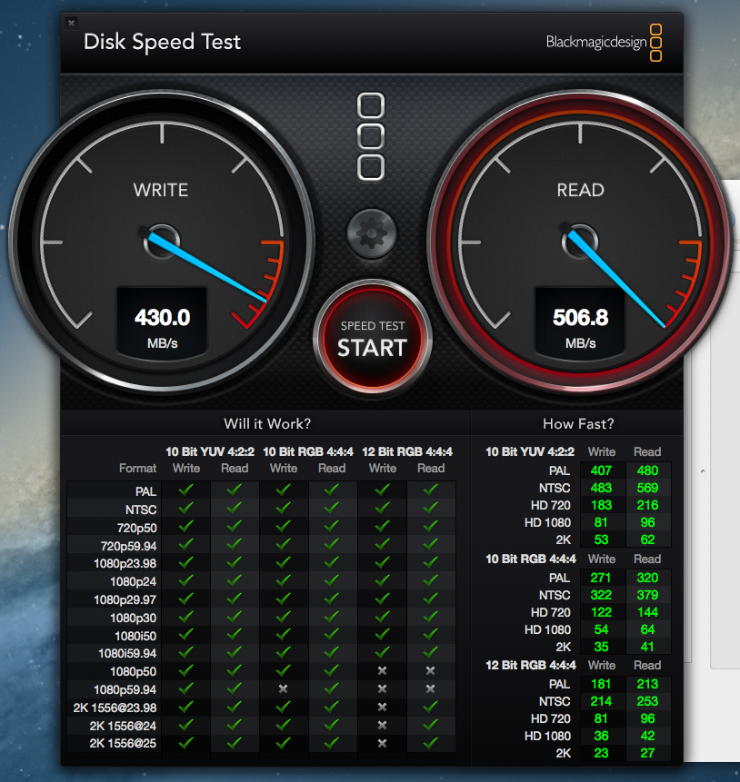

If you decide to open iMac look at the Samsung SSD 840 EVO 1 TB. On the iMac MD095 to load the OS I used an external Lacie Little Big Disk Thunderbolt. Now I use iMac MD096. I installed Aplle 256 GB SSD and replaced the 1 TB HDD Samsung 830 256 GB. Two SSD united Raid 0. The speed is just fantastic.

I replaced the original HDD Samsung 830 256 GB.
Installed the Apple 256GB SSD.
Two SSD in iMac combines Raid 0 with striping
