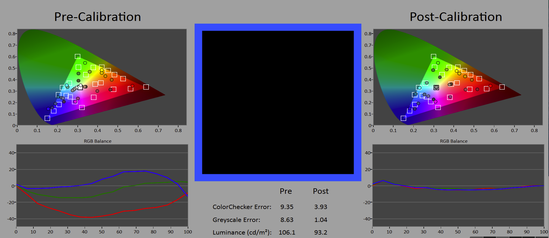

Hi,
Sadly the calibration file here is not calibrated correctly, here is one profile that I have calibrated by my self according to colorspace: HD Rec.709 and Gamma: ITU.B 1886.
As you can se in the pre and post picture of the calibration the MBA screen's CMS is not so perfect, but hey what have you expected with this screen, this profile make the screen much better.
I did use CalMan RGB and SpectraCal c3 meter.
The greyscale have a overall DeltaE of 1.04, you can't se errors under 3.0 with your eye.
Every step in the greyscale is under 3.0 in DeltaE
This profile is calibrated for Macbook Air 2013 with LG screen.
Pre and Post:
Se attached Thumbnails
The profile:
Download it here

Thanks! I gave it a shot and it seems very odd...not sure why but it's not very pleasant for my eyes. Could just be a personal issue 😛
You need to pull your brightness down a bitt manually on your keyboard, the profile do not adjust the brightness.
This profile is for a 11" screen.
Gotcha 😎
Reaply back what you did think of it after you have adjust the brightness on my MBA it's good, but some color's the primary is a bit off, don't know if you notice it, but for me who is use to perfect colors I notice it.
But its much better then the original profile.
