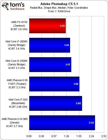

    At these clock speeds photoshop doesn't really saturate the CPU cores to take advantage of hyper threading. It does hyper thread but is also offloads a lot of processing to the gpu so this is just as important with photoshop work.
    This maybe of interest as a very high level indicator
    [​IMG]
    Please remember this shows times for a chip 2 gens old and an older version of PS.
    The i5 has a slower clock speed too.
    The reports from people benchmarking these things, ie setting up benchmark scripts to apply rules and filters and timing it seem to suggest an i7 advantage is fairly indistinguishable with only around 5% improvement.
    However on batch operations you may just see some advantages. I think certainly you would see render advantages in video providing the program supports ht, iMovie doesn't but something serious like FCP does.
