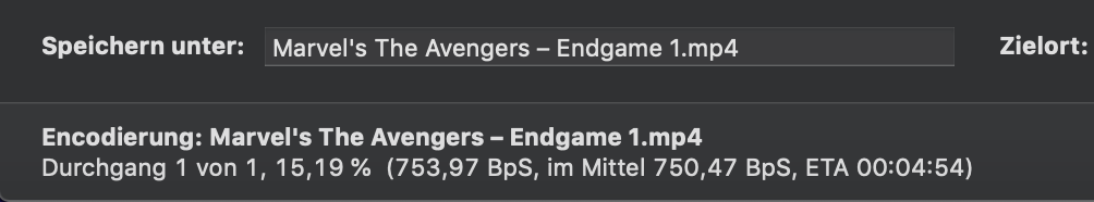

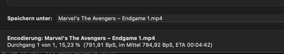

TzunamiOSX
macrumors 65816
Oct 4, 2009
1,019
412
Germany
paid $1000 more to have 6-core and better GPU (2014). The issue with Handbrake is that the Xeon goes into thermal protection (70C air coming out, slowdown) after about 10mins, and I had the fans cranked up to 1300rpm already. More, they get noisy and suck too much dust.
My Studio M1 max Handbrake is 5x faster (200-250fps) and 10x faster using Compressor. Does not get warm, rendering for hours.
IMHO, M1 (now M2) is the way to go. Even the M1 Mini (599) is at least twice as fast as my 6-core Xeon. Mini stays cool to the touch rendering non-stop.
I have the M1 max, paid $200 for the extra GPU, and the Compressor update earlier this year now really flies; went from same speed of Handbrake to almost 2.5x as fast. This rig is so fast, now the bottleneck is my editing speed in FCPx.
There is no software, so the dual D500 is just for the display. There is a terminal-command in BigSur to enable scaling on 4k display: 3008x1600; 144dpi.
But you can add an eGPU to your MP2013 and fly away:
Mac Pro with Vega Frontier and I would say a 6800 is a bit faster
M1
You get this speed only with Videobox who is hard limited (2 Ref frames for example).

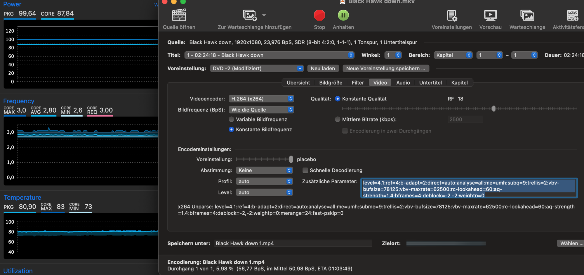

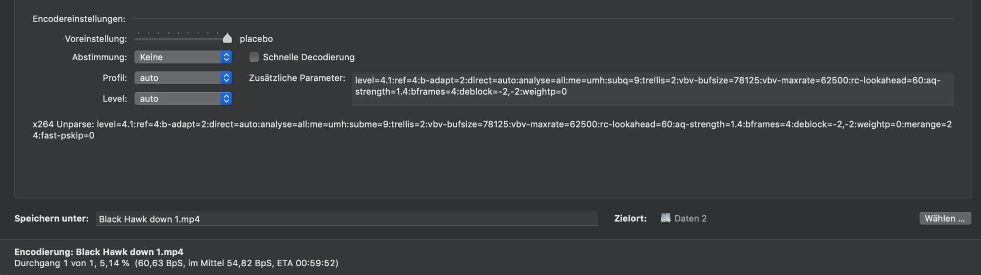

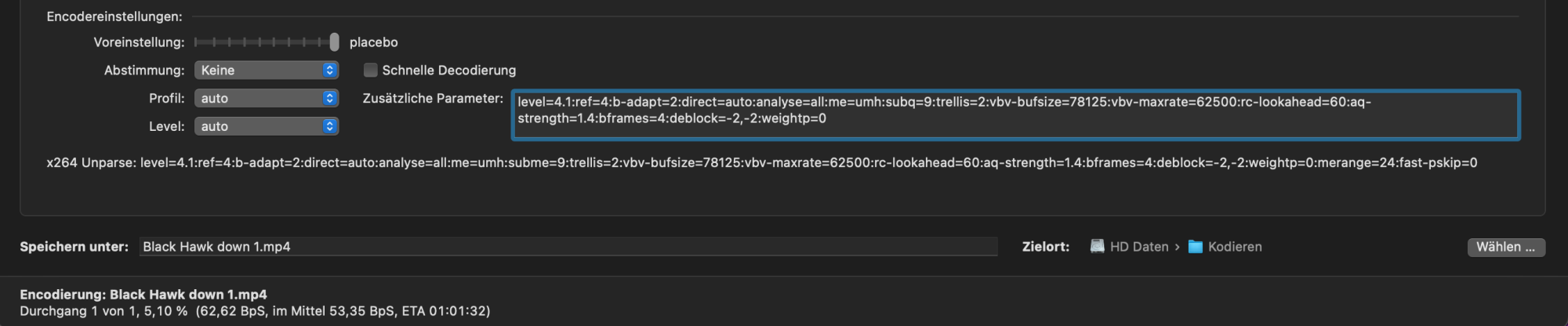

TzunamiOSX
macrumors 65816
Oct 4, 2009
1,019
412
Germany
No problems like this. CPU is 100 MHz over specs, so turboboost is running. Temp is 80 °C, 86 °C is Tmax.
Mac Pro 6,1, Handbrake CPU AVG 50,98
Mac Pro 5,1, Handbrake CPU AVG 54,82
