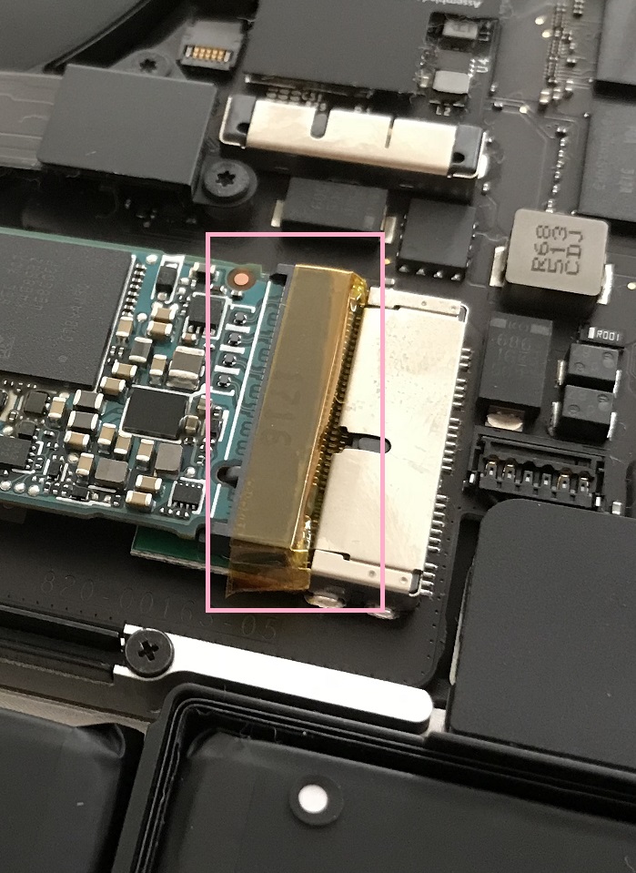

Did you apply kapton tape to the adapter?

I'm new to this. What is kapton tape and I'm not sure if it had High Sierra previously but the drive is detected in the High Sierra USB install.
I think I already saw some orange type on the adapter.

See the picture for the taped area.

Also, I will take a photo of my adapter when I get home but I do remember that tape being there when I received it.

I understand your hesitation but adding kapton tape to both sides of my green adapter, which only worked at x2 in my Air 2015, changed to x4 but didn't affect anything else. I did not have any reboot or sleep problems with the Intel 600p.
Would you be able to post close-ups of how you applied your kapton tape? All other photos on the other thread aren't very detailed or up close.
