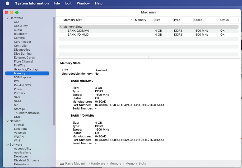

My recent research suggests, "certain" Mac mini 2014, Part no A1347, have logic boards, with 2x DIMM Sockets, taking SODIMM DDR3 PC3-12800 204pin DDR3-1600 1.5V
This is from my Mac mini Late 2014, i5 1.4ghz, 8gb
Info on memorial model

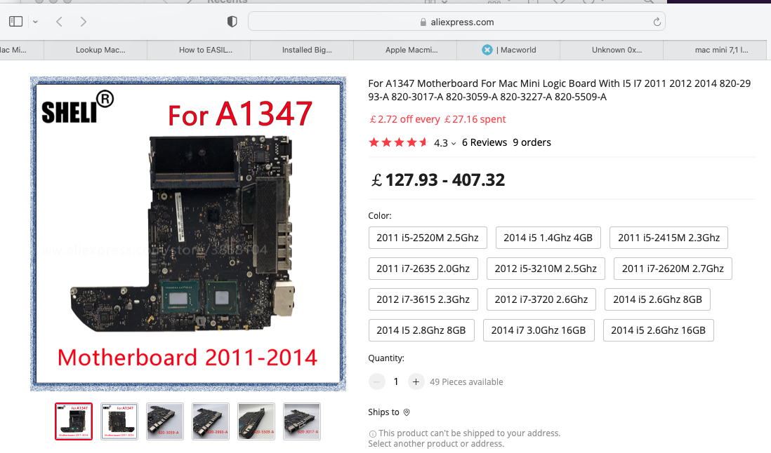

A1347 Logic board on Aliexpress...
Even suggests CPU & GFX Chip upgradable
Those are just standard CPU options that were available from Apple. Presumably one could solder on a new CPU, same as Apple did with those boards.
The picture is of one of the 2011-2012 boards, not a 2014.
In spite of how the RAM is reported in System Report, there are no DIMM slots in any 2014 Mac mini.
