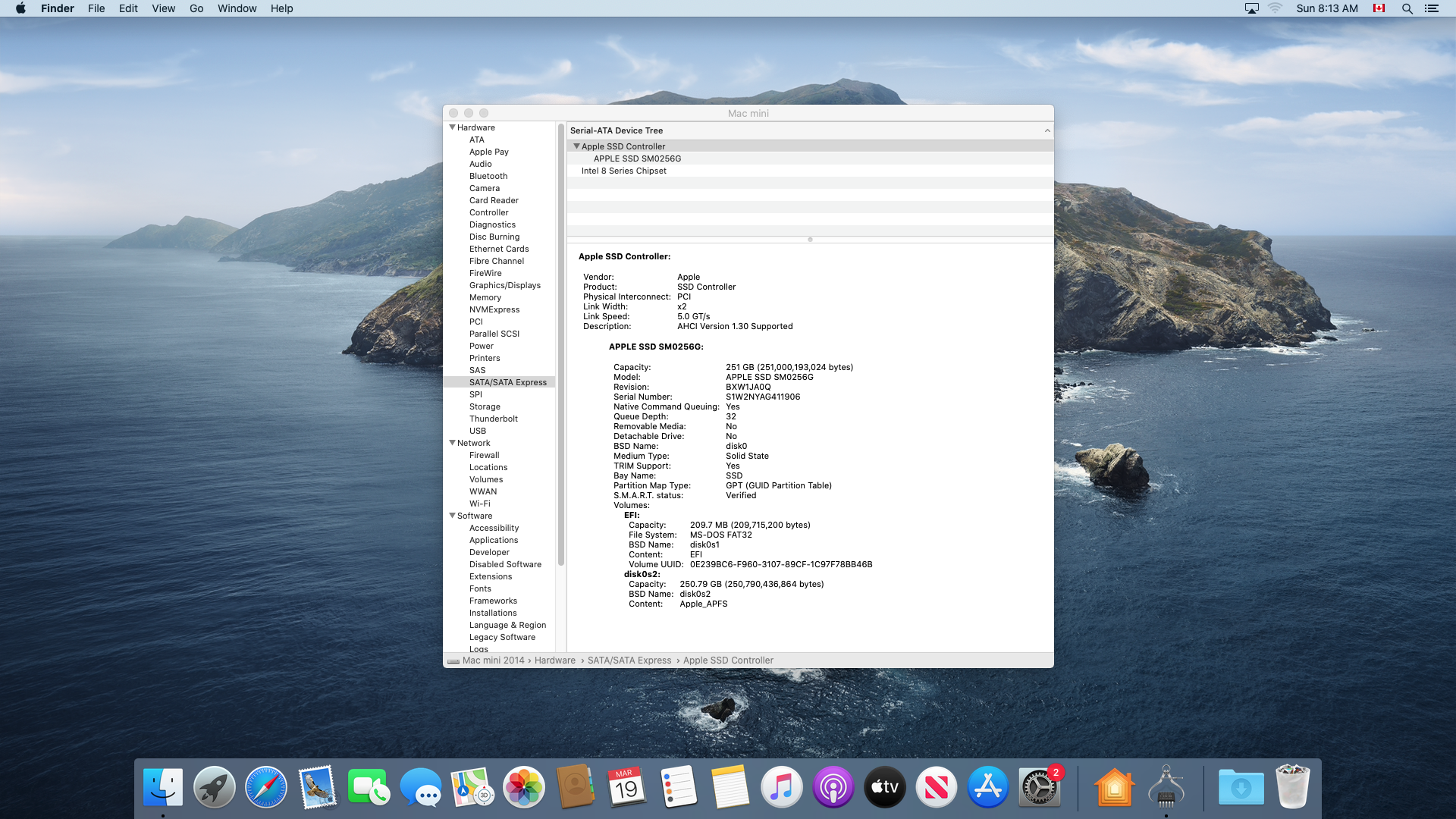

So I bought a used 2014 Mac mini (2.6GHz Dual Core i5, 16GB RAM) that I have just decided to use as a media (and maybe music) server on our home network. It has a 256GB SSD, which I thought was one of the PCIe ones. But, looking at my system info, I see nothing under NVME or PCI. The screenshot is what it shows under SATA. So does this mean it already has the adapter for an SATA drive, and the Samsung 870 EVO I recently bought could be used in it? And that I could swap the 256 SSD into my late-2011 MBP (where I had originally intended to put the Samsung)?
Or, will I have to open it up to know what's inside?
It is. It’s not an NVMe PCIe SSD though (those only appeared in 2015). It’s an AHCI PCIe SSD — the "SSUBX", which is a custom version of the Samsung SM951.
All AHCI PCIe SSDs show up under SATA, presumably because the OS assumes all AHCI controllers are for SATA drives.
You can put in any 2.5" SATA SSD in place of the hard drive.
No. It is not a SATA SSD and doesn’t use a 2.5” form factor either.

Yours is one of Apple’s custom SSDs, indicated by the “APPLE SSD” bit in its name. “SM” indicates it’s based on a Samsung drive, and “G” after the capacity indicates it’s an SSUBX, i.e. an AHCI PCIe SSD based on the Samsung SM951.
And now I just noticed that the screenshot does say it's AHCI version 1.3, so I'm really confused
It says it’s an AHCI SSD, and “Link Speed” and “Link Width” say its controller connects using two PCIe 2.0 lanes. The SSUBX can use up to four PCIe 3.0 lanes so the Mac mini bottlenecks it somewhat, but there’s nothing that can be done about that.

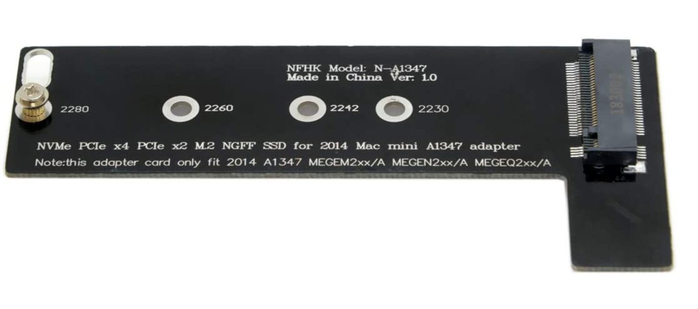

So I found this connector, which I believe would enable me to install an M.2 2280 configuration PCIe SSD. It's challenging to find out if they have DRAM cache. Given what I want to use it for, is a DRAM cache a big deal? For example, would there be lag while watching movies?

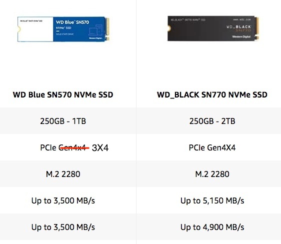

Looking at this drive for my 2014 2.6GHz mini with the Sintech adapter. The list often referred to on this subject lists this as a compatible drive "with firmware update". Presumably, this would have to be done before installation? How?
Also considering this one. They are close in price, and both ship from Canada. Any thoughts?

While that particular adapter is available via Amazon.ca, it'll come with associated duties. The Sintech one is also one recommended in the PCIe NVMe SSD upgrade thread here with no duties attached. But thanks for the info.
I do not think that it is necessary to purchase the Sintech adapter. I bought a clone from eBay and I haven't experienced any of the issues described by the OP in that thread.

Have just bought the cheap Adapter from jser and put a Crucial P2 in it ( Cheap - 5min install ) but do not take any Samsung NVME in a Mac as Boot Volume cause the Trim is giving you many sort of Problems in any Mac with any Samsung NVME.

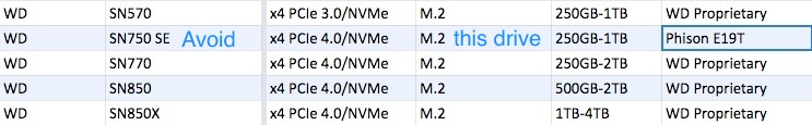

As we've progressed on from Monterey to Ventura it looks as though the WD Blue and Black NVMe drives are still the very best choice for your macOS boot drive. Samsung has not fixed anything through firmware updates that would let us suggest their NVMe drives for use in your hackintosh. Those would need to have TRIM disabled for use with macOS as a boot drive.
TL;DR : Use WD Blue or Black SSDs with a WD Proprietary controller (avoid the WD SN750 SE)
Choose a 500GB or larger drive for faster read/write speeds and greater longevity of your drive.

Agreed, but it's worth keeping in mind that the 2014 Mac mini is limited to PCIe 2.0 ×2 for SSDs, i.e. 1000 MB/s theoretical maximum, even less once overhead is taken into account (800 MB/s or so?). So pretty much any NVMe SSD is going to be bottlenecked.
I know, but that text purely relays to another context and the most important part here is compatibility.
These transfer rates are also only reaching Maximum with Large files.
