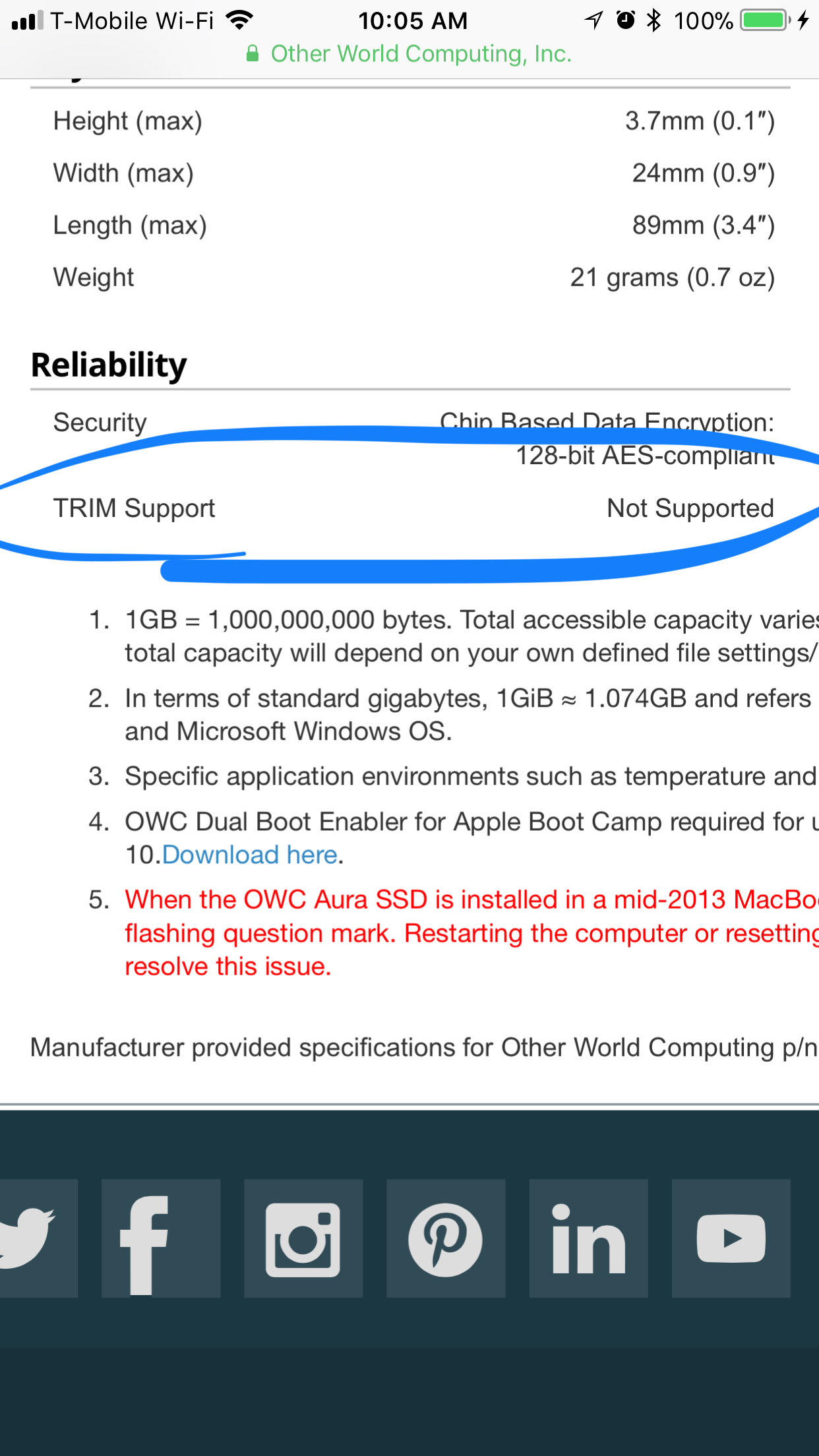

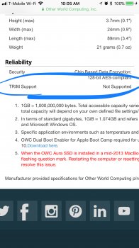

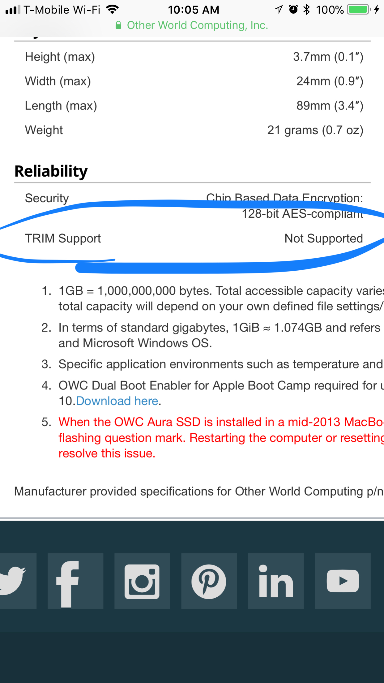

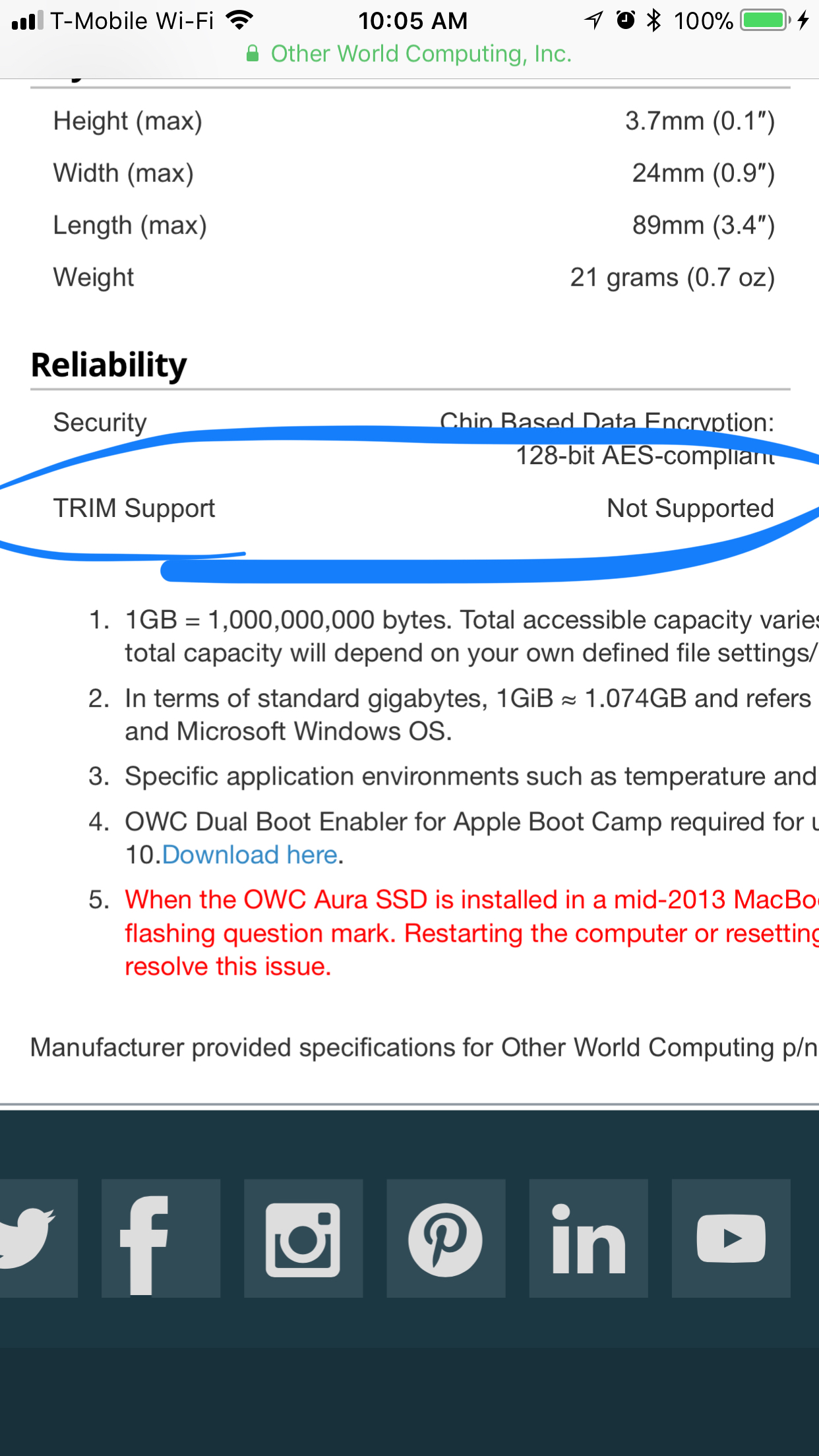

Not on the drive for mid 2013 to later MacBooks (pro/Air). If you look at the spec sheet on owc’s site you will see that the drive itself does not support TRIM for this model. Other OWC drives do support TRIM, just not this one.

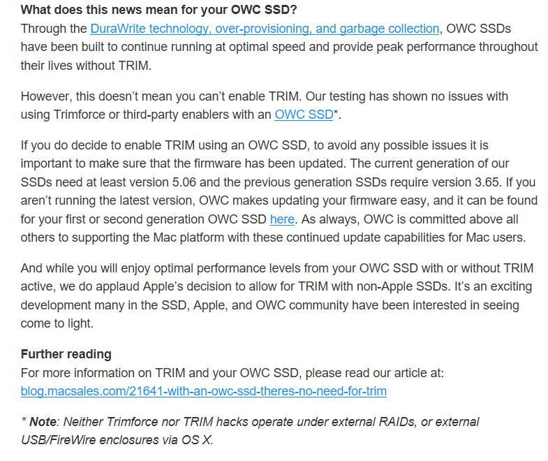

They might mean it doesn't natively support it. You CAN enable it.
https://blog.macsales.com/31602-owc-ssds-built-to-perform-with-or-without-trimforce-command
OWC actually gives you instructions on how to do this:
https://blog.macsales.com/31619-how-to-execute-trimforce-command-with-your-owc-ssd
And just for reference
No you cannot enable TRIM on a SSD RAID which OWC's drives are. It may report as TRIM enabled, but it really isn't, even Windows can't do TRIM on a SSD RAID (what's worse is OWC uses crappy Sandforce controllers - no modern SSD uses them now!) The other posts above are 'generic' and really only apply to 2012-early 2013 and EARLIER models which used SATA based SSD's. late 2013 on MBP's all use PCIe. MCE tech prices are just as bad as buying used Apple SSD's on the auction site. I bought a 1 TB Apple OEM SSD from ebay several years ago and it's still running strong on my 2013 rMBP 13. MAKE SURE IT'S SAMSUNG. All the other SSD controllers stink, even Apple OEM ones using Toshiba/Marvell controllers. (Apple's NVME controllers seem to fantastic OTOH)
