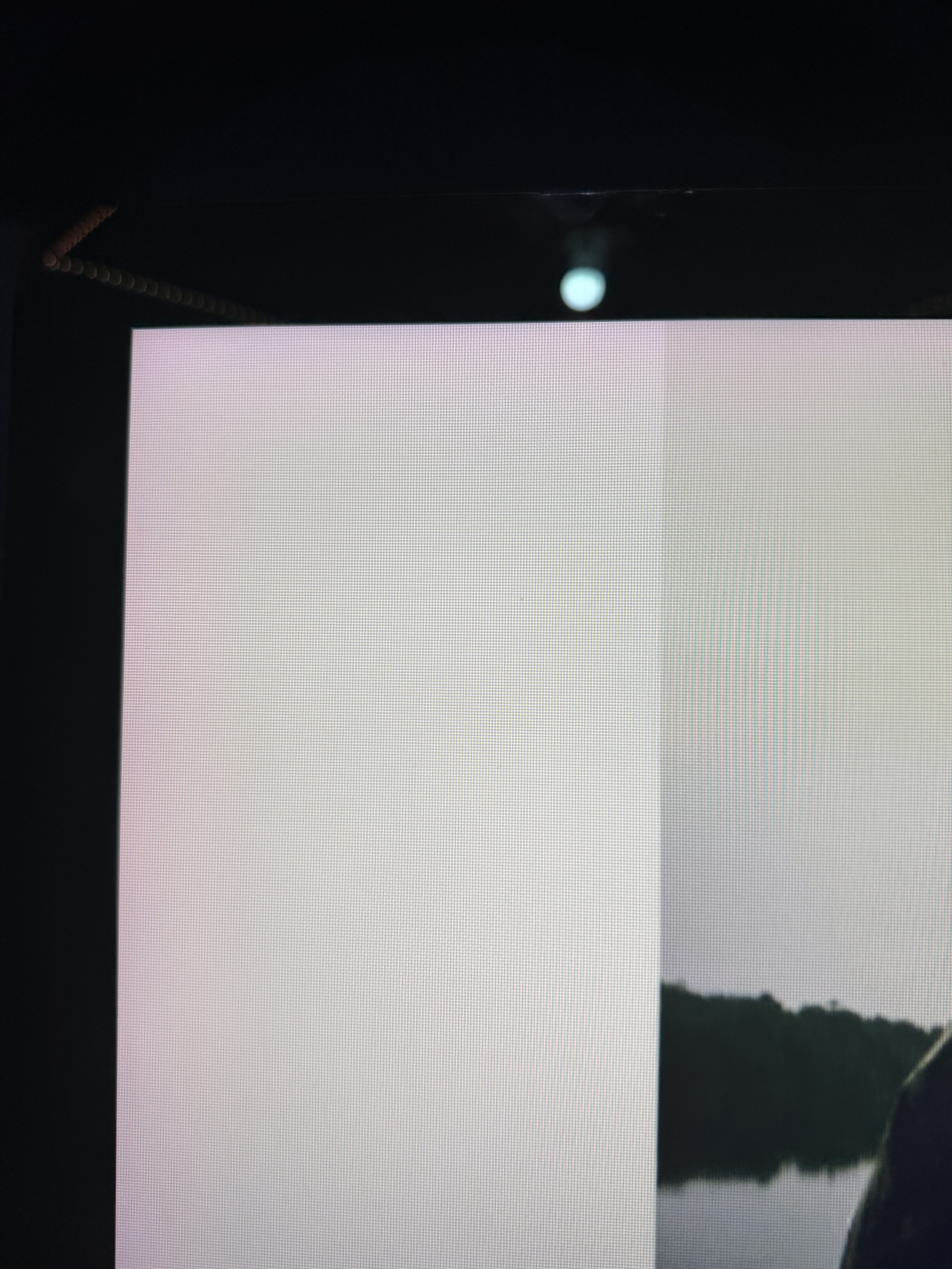

I have a 2015 27" iMac that I converted to be a DisplayPort 5K monitor a few years back, and in addition to some image retention/ghosting going on if I leave windows on the screen too long, I just noticed today the pink discoloration around all four sides. If this is indeed because of removing and reattaching the screen, I'm wondering if I should remove the screen and use new adhesive strips. But if this is just a result of the panel aging, then I guess I will just live with it for now. 🤷🏻‍♂️ Just a shame as every other part of the display is pretty impressive for an 11 year old panel.
It's the panel and these symptoms are common on the 2015. I have them both in mine and it's still an iMac.
Have there been many reports of this affecting the 2017 models as well, now that they are also getting up there in age?
To be clear i believe the pink fringing is due to some sort of dust or residue accumulating on the fringes of the optical diffusion layer. I have a suspicion that it's some sort of residue created by adhesive breaking down in the panel with age.
I tore apart a panel once for other reasons and in that case it was something you could wipe off. Of course the problem with that is that it is impossible to do that without contaminating the panel in some way with other bits of dust or debris ... and the optical diffuser is extraordinarily sensitive to imperfections.
The pink/mauve edges on my device don't seem to have gotten any worse after years of regualr usage, so the "red adhesive running/residue" theory seems reasonable (SSD had been inserted by a previous owner so screen removed etc).
