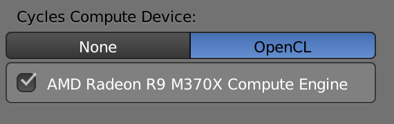

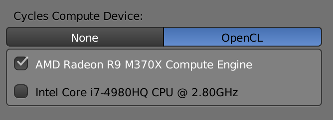

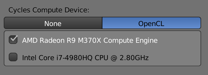

Affinity Photo and Affinity Designer are utilising the Radeon dGPU as well as Adobe CS6 apps. If there are problems with some certain buggy app, that absolutely can occur, I use gfxCardStatus to switch manually to integrated Iris Pro.
I had preferred a Nvidia CUDA option as well, but that wasn't offered. The NVIDIA GeForce GT 650M in a 6 years old 2012 15" MBP is still working perfectly 24/7. I have no experience with eGPU so far.

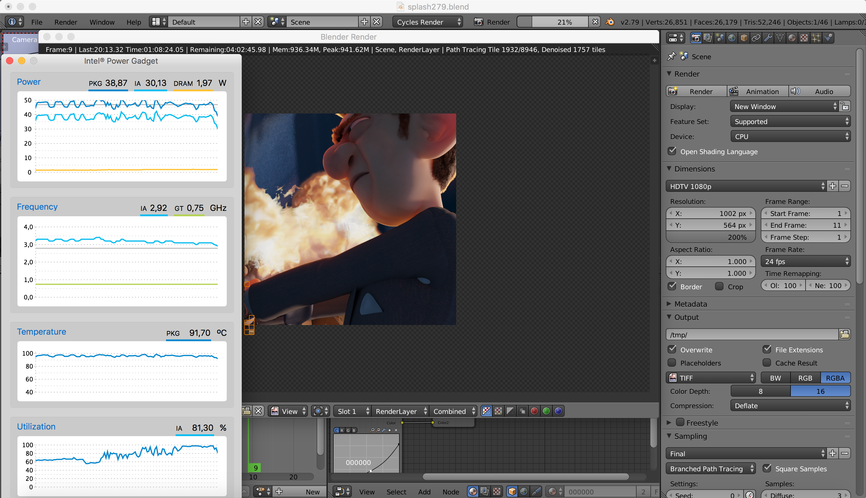

Try the Intel Power Gadget.
Thank you for that hint. I'll report back about CPU throttling while rendering with Blender.

No CPU throttling noticed while rendering for about 1 hour with an average CPU speed of 3 GHz (4 cores). Fans were loud, CPU hot, but I guess not too hot. Blender utilises AMD dGPU.
Great info, and cool looking render.
Looks like you're pretty close to 100 deg. C. But that's great if there's no throttling. Also interesting that Blender now works with AMD GPU.
Yeah, there were peaks at 100°C, but average temperature was around 96°C. AFAIK AMD support was recently added in Blender 2.79. It seems that the upcoming 2.80 release can even utilise OpenCL without dGPU (see screenshot).
