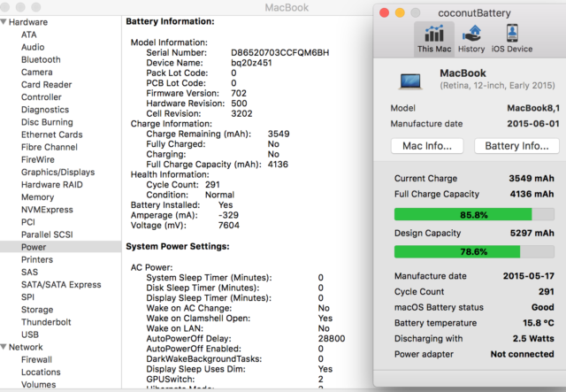

Battery fluctuates between 70% and 80% - both conditions reporting "GOOD" by Apple and Coconut Battery:

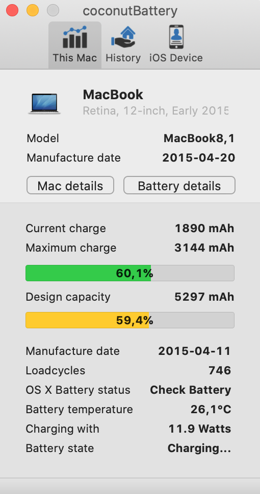

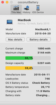

Your battery is in better condition than mine thou.I have 746 cycles. But at 70% yours might starting to have trouble with a cold start. Room temperature in the morning before firing up the wood stove is about zero to 5C.
