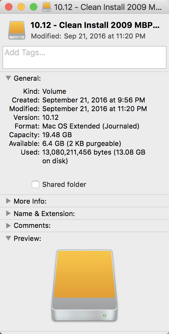

Clean install of 10.12 Sierra is just around 13 GB. I just checked my backup install.
That's from a standard clean install. You've got some junk in your install. It sounds like you have not done a clean install.
