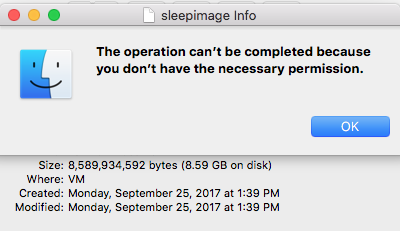

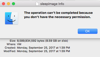

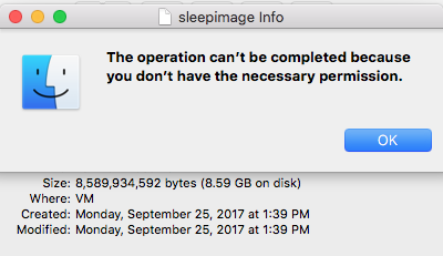

Just to expand on this topic a little, does anyone know how to remove the (/var/vm) sleepimage. I have tried all of the solutions that worked previously, but when I try now I get the following:
Thank you.

chown first
I just tried....
sudo chown -v username sleepimage, the system returns "Operation not permitted".
I also tried to take ownership through Finder...Get info, system returns:
This thing looks like it is locked down, guess I have to live with it.
Thanks....

In order to remove the sleep file which is required for hibernation you have to disable SIP in recovery. If you’re sure you want to do this then after disabling SIP you can execute the following commands:
Code:
sudo pmset -a hibernatemode 0
Code:
sudo rm /Private/var/vm/sleepimage
Code:
sudo touch /Private/var/vm/sleepimage
Code:
sudo chflags uchg /Private/var/vm/sleepimage
After that you can re-enable SIP.
