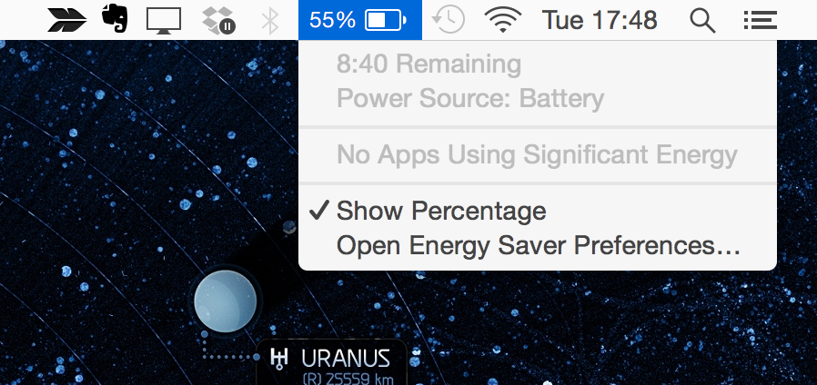

Good news
To spoil some 'statistics' I must report excellent battery life (fig attached) and no UI lag what so ever. I have two retinas (2013 and 2015) and air (2013), 2xiMacs (24" and 27" - all running Yosemite which looks I don't like) - the same thing there.
Enjoying a great and super stable OS X + serious piece of engineering (that only good-old IBM Thinkpad could challenge) which I use professionally in at least 99% - I get 8-9hrs but doing serious stuff (openFOAM, R, Python, Terminal + a lot of writing and editing) - not browsing for pictures of nice cats and updating my status on FB and T. But I can also get 3-5 hrs doing heavy stuff.
Some tips (some of you may not like - feel free to skip it):
1. For those always looking at battery gauge - turn this thing off :cool:
2. Stutter is your problem? - cool off and stop tinkering with default settings it is not windows. You must allow some time for a new machine to index everything etc. Just give it 2-3 days then take out your watch and measure animation lag ;)
Ultimately - make a real clean install of OS and stop tinkering with system settings :D
3. Still not satisfied? - sell it and buy windows machine - then you will spend extra more time with setting this sh** up (I've been there for more than +15 yrs).
Do however visit Macrumors Forums because without your real or imaginary problems there will be no business and ads and they will have to close it. :rolleyes:
Best!
