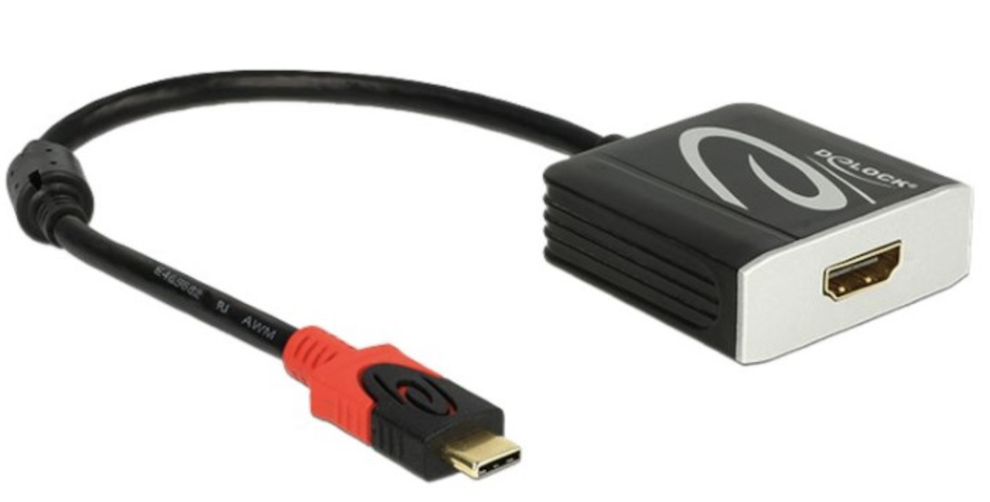

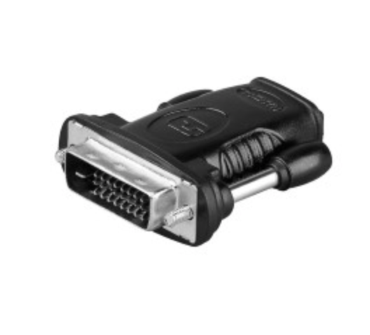

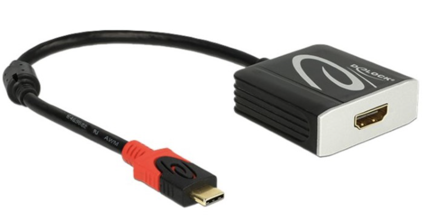

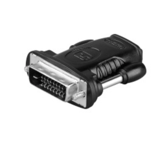

Hi.
I have an ageing DVI 23 inch Apple Cinema Display which I have successfully connected to the new 15 inch MBP.
I tried a couple of different DVI to usb C adapters with no success. The computer recognised that the Cinema Display was attached but only displayed a black screen.
What worked was to convert the DVI from the Cinema Display to HDMI with a small cheap generic adapter, and then use an HDMI to usb C adapter to connect to the computer. The HDMI to usb C adapter I am using comes from De-lock and supports 4K at 60 Hz, although I also tried a cheaper HDMI to usb C adapter with only supported 1920 x 1200 (the upper limit for single link DVI I believe, which the 23 inch Cinema Display has) and it also worked.
Good luck
View attachment 676287 DVI to HDMI
View attachment 676289 HDMI to usb C
