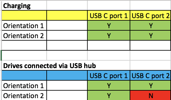

I hope the table itself is self explainatory.
Whether I charge through the hub or not, the behaviour is the same. Again, refer to my table.

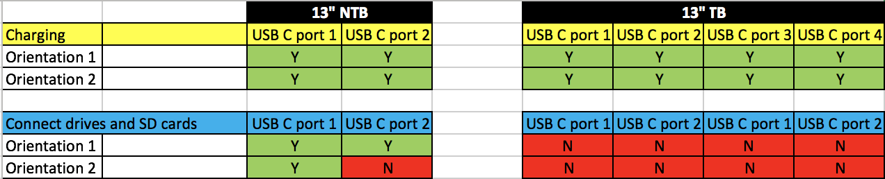

Ok this is really weird.
Got my 13" TB today, and guess what, the Hootoo USB hub would not work with any of the 4 USB C port! But the hub is definitely working on the 13" NTB, except for the issue described above.
I refuse to think my brand spanking new TB MBP has 4 faulty USB ports. Power charger is working via all 4 ports. What's going on?!

Or, you may have confirmed that your HooToo hub is faulty.
The Apple-supplied connection is 100% working.
Your choice for a third-party device: 25% working.
I'm thinking that you need to test a different device now.
