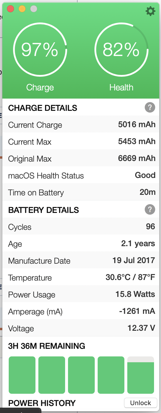

My trusted 2017 MacBook Pro seems to be losing charge at a rapid rate these days. It appears I have lost 18% of its capacity over 2 years of ownership, and only 96 cycles. Is this right? Surely it should be lasting longer than this, and not be degrading this quickly?

My wife and I have a 2017 MBP - a year and a few months of ownership (purchased at same time last year).
She has 92 cycles and 94.5% capacity.
I have 55 cycles and 97% capacity.
Do you have AppleCare+? If that dips below 80% you're eligible for a free replacement. Apple says on their website you should be able to hit 1000 cycles and maintain >=80% capacity.
So definitely looks like your battery isn't living up to par. May be able to ask for a replacement.
Try doing a battery calibration/reset. What is that? Charge the battery to 100%, then drain it until your Mac self shuts down.
Charge for the next few hours and then check your battery status. If it still shows up as 82%, then it's likely a faulty battery.

Are you usually plugged-in? If so, the cycles count can be pretty irrelevant to the overall activity that the battery has sustained while maintaining a constant full charge.
Judging by the cycles vs. years of ownership, it seems like you mostly leave your laptop plugged in. That would explain the poor battery health as lithium ion batteries degrade the fastest when they are full or near full. Keeping it at 100% most of the time is worse than cycling it each day. If you want to get the longest life from your battery, you should do partial discharges, not going too low or high and not exceeding about 50% at a time (e.g. charge when it hits 25%, then unplug when it hits 75%). You may still want to do a full discharge/charge every few months so that it remains calibrated and displays the correct percentage.

Does the laptop still work on battery power for an expected/reasonable amount of time? That’s all I’d be worried about to be honest.
If it doesn’t, then get in touch with Apple. I’ve never understood the obsession about battery cycles on this forum.
