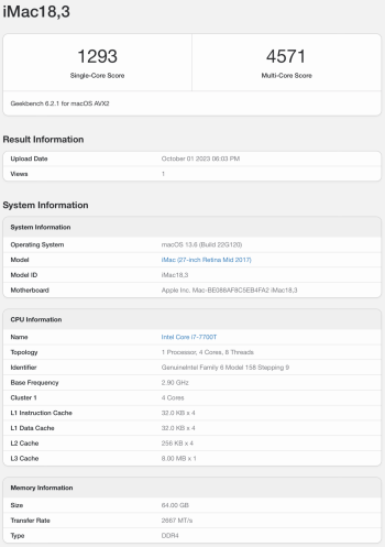

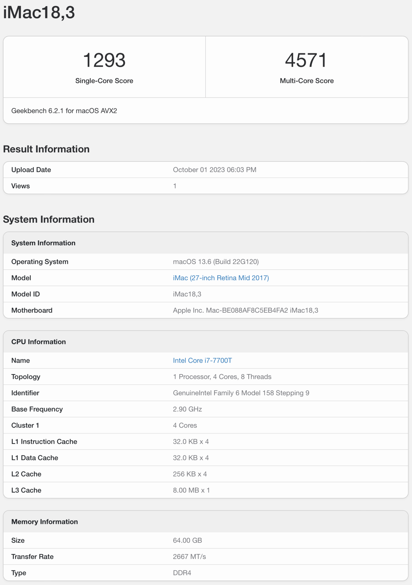

So, if anyone is still interested, I made the change from i5 7500 to i7 7700T in my 2017 27" 5K iMac. Works flawlessly, the fan stays at 1200RPM no matter what benchmark I run. I attached Geekbench 6 results.
