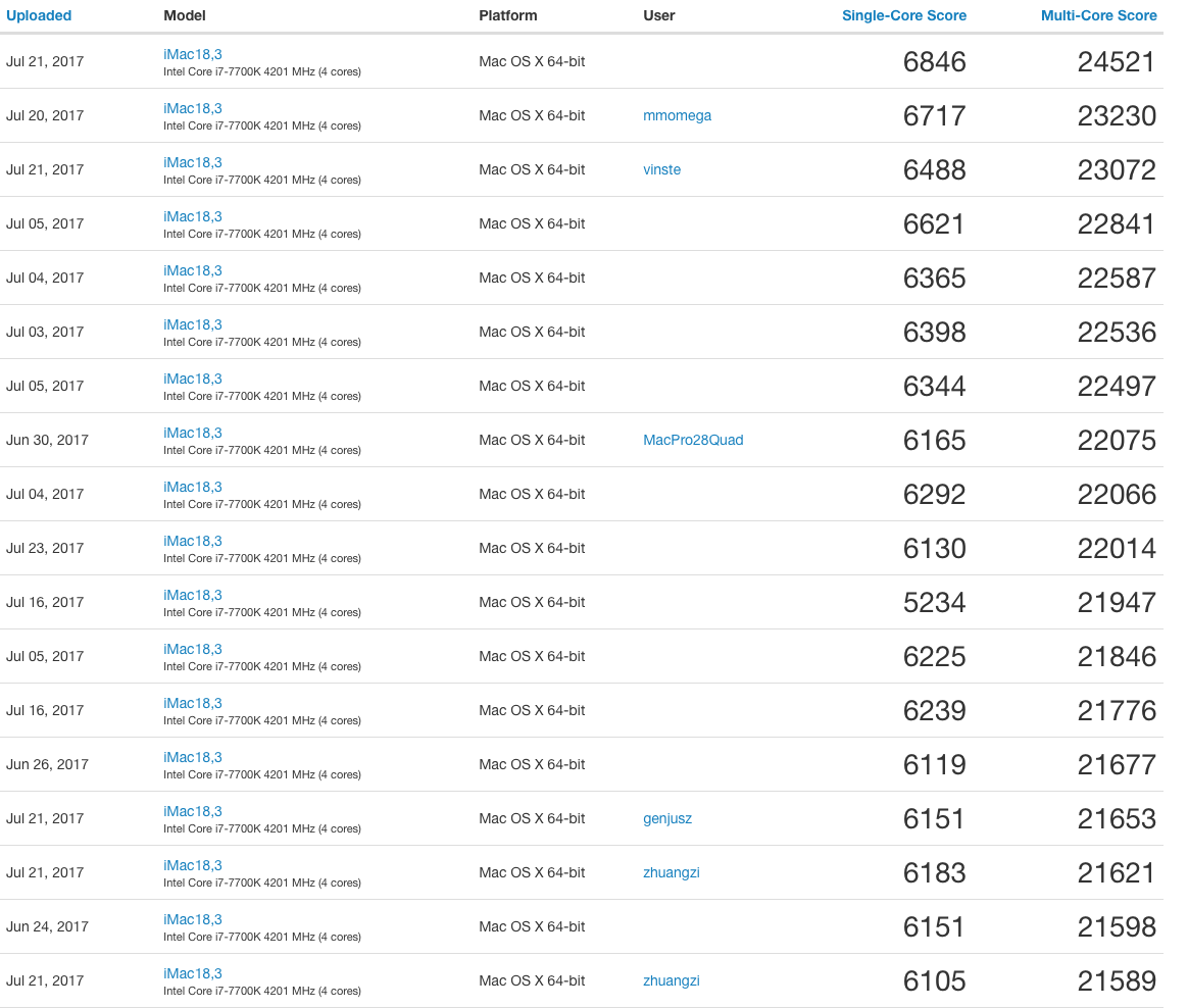

Looks like they are possibly using runt 7700ks as well.
That video is deceiving, probably not intentionally (I like snazzy labs) but just from lack of better understanding of Geekbench. He used the generic geekbench score found on their webpage.
However if we look at the actual scores you'd see this....
Have to go a couple of pages in to find a score as low as his.
Since its a synthetic benchmark and you can run it 20 times and get 20 different scores, therefore there are scores much lower than his.
Point is you are going off bad information. Kaby Lake i7 CPUs, especially unlocked CPUs (K series) don't have runts. The runts have features turned off, cores disabled etc then rebadged and moved down the chain to become other models.
