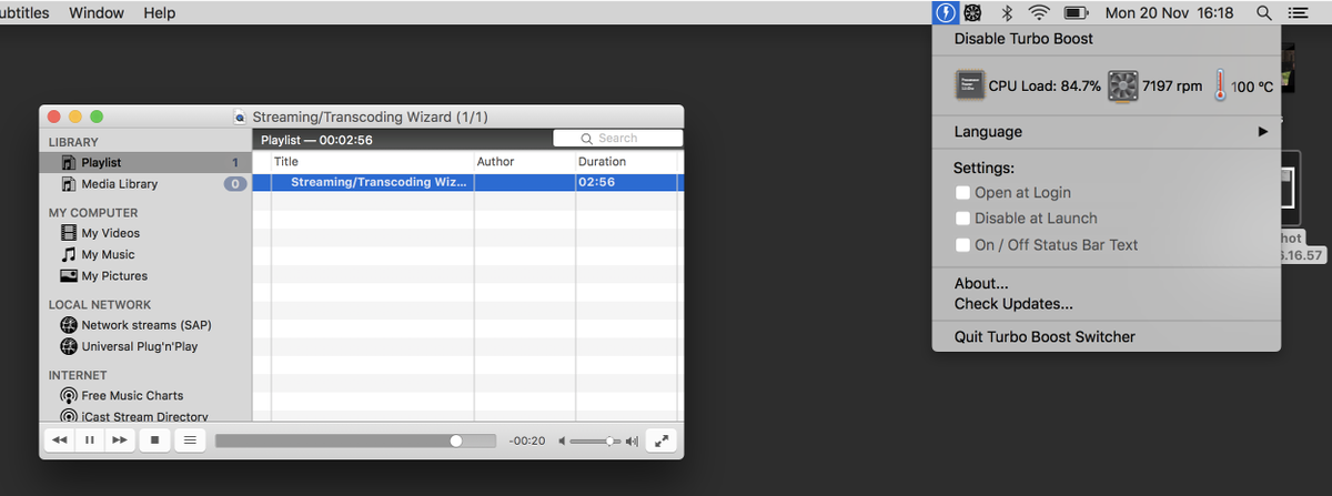

My 2017 MacBook Pro 2017 nTB hits 100C within 3 minutes of video transcoding .. my 2015 MacBook pro didn't do that

I'm obviously not happy. It's supposed to be a "pro" laptop from 2017.

I don't get the problem. As long as the surface of the notebook is not uncomfortably hot, why shouldn't the CPU run at a temperature it can comfortably run at? Also, there is no thermal throttling on the current MacBook Pros, they just can't hold the maximum possible turbo frequency forever (the TouchBar-model obviously fares better here with it's two fans) - which is totally normal and the case with just about any notebook using Intel's 15W CPUs.

Why wouldn't it? The CPU is designed to operate under these temperatures, so the cooling system is designed appropriately.
P.S. I'm quite sure its 100C and not 102C, maybe your readout is malfunctioning.

Because 100 is teh maximum according to Intel themselves. https://ark.intel.com/products/97535/Intel-Core-i5-7360U-Processor-4M-Cache-up-to-3_60-GHz
To get this hot for small tasks is bad.
To try to run for any developer or "pro" workloads for hours is going to damage the laptop and reduce its life.

I'm running my Mac Mini for more than five years now with the CPU reaching 105° C a lot of the time - no problems yet. Also, converting a video is not a "small task", it's certainly a task that can utilize the full power of the CPU. Obviously Apple could down clock it - and reduce the power of the notebook while doing so - but why should they? 100° is fine.
Can't comment on the heat damaging the display - never had that happen and it's the first time I hear this. This would be bad obviously. But if heat bothers you that much, why didn't you get the tb MBP with it's much higher thermal capacity?
100C is the maximal safe operating temperature of the CPU, according to its manufacturer. So the cooling system keeps the CPU within its design parameters. Again, I don't understand what you are complaining about.

Its not a "small task" — its a task that pushes the CPU to its computational limit. You'd be hard pressed to find a real-world task that is more demanding than video transcoding.
My 2016 MBP had none of these issues and could run jobs for hours .. as you would expect from a pro laptop.
Again, your computer operates within its thermal specification. There is no problem. You'd have a problem if its reaching 100C too quickly and would be throttling as a result, but its not something that we are observing. Laptop getting hot to touch when watching videos etc. is perfectly normal.
