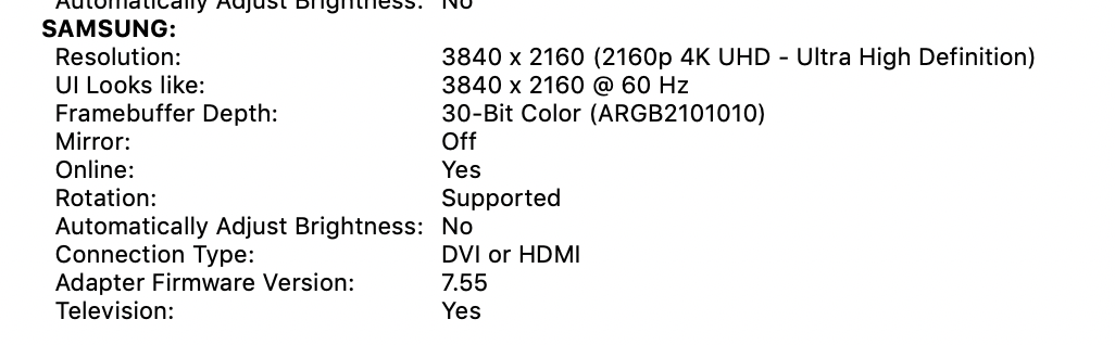

My 2018 MBP i5 2.3hz w/ Touch Bar gets 60hz out of all four ports. This is the right side.
I did have to enable UHD colors in the TV's settings to get 60hz (locked at 30hz) however that applied to all the ports.
