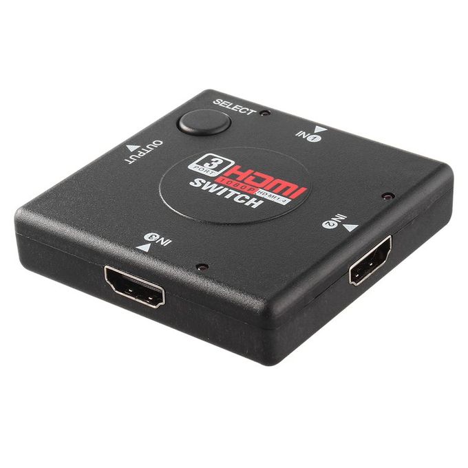

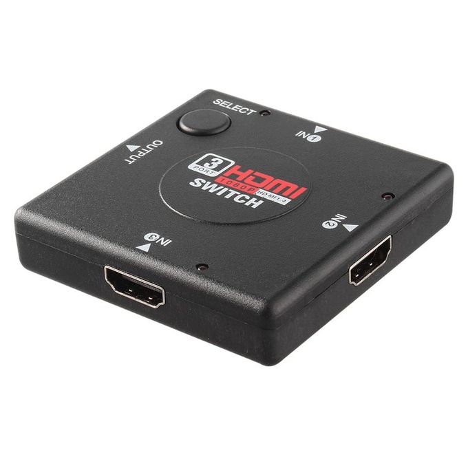

After much trying, I came to this decision.
Not very smart, but it works. I connect the splitter consecutively, and when the problem occurs, I press the button three times
This is essentially just disconnecting and reconnecting the hdmi, right?

I have had this issue since the 2012 Mac mini. I have a 2018 mini with Catalina, and still have the issue. I have tried every troubleshooting under the sun, except getting the USB-c to display port cable.
That was the fix my my 2018 mini.
