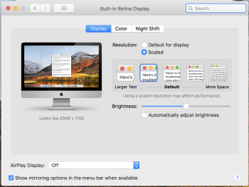

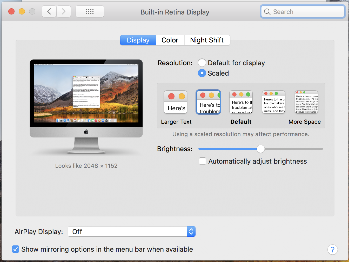

I’m looking for some help. I want to replace my 2015 27inch 5k iMac with a new Mini and monitor. I run my iMac resolution at 2048 x 1152 (as below) and sit just over a meter away. But ideally I want a larger monitor that I could still give a similar resolution. I’m happy to go as large as 43 or 46, and setting it further back. Can the Mini support that size and a suitable resolution without an extenal GP?
I'm pretty useless on monitor tech (deu to using iMacs for the last 6 years), so don't really understand all this resolution stuff. I don't really care about 5k necesarill, it's mor important for me to get a large display and be able to sit further away (for optimized mixing stuido ergonmics and accoustics purposes).
Any advice appreciated

Providing you have at least 16GB RAM and don't do anything that's graphics intensive, any scaling on a 4K monitor is fine.

I would agree you need the 16gb of ram. I have a setup with 4k but with 32" monitor and works great. At the end of the day don't think it makes a difference what size of monitor because 4k pushes the same amount of pixels regardless. Thus far work like a charm. I opted for the i3, quad core and have done video editing and other things with no problem. Very inexpensive compared to iMac.

If you want a LARGE display, you might consider full 4k (running pixel-for-pixel) on a 43"-50" display... possibly a high quality 4k tv.
For anything smaller than 43" (you might get away with 40"), I would think 4k (at full resolution) would be just "too small" to be useful or pleasant on the eyes.
Speaking only for myself (with 70-year-old vision), I prefer 1080p on 27", or 1440p on 32".
But that's just me.
