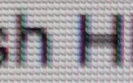

So Glad To Find This Post, Here's Some Evidence!!
I have the same issue on my 2018 MBP. I think of it less as "blurry" and more as something like "chromatic aberration" (for those familiar with that distortion in photography). What's happening is an inability to have a crisp edge to a line. Instead, there is a band of color at the edge. Since small fonts have many such edges, they light up with extraneous colors.
I think the reason Apple can get away with this is because it's a subtle issue and many people won't notice it.
Here is some evidence of the issue:
I took photos (not screen captures, but photos of the screen itself). Then I cropped out just a tiny portion of the photo.
The photo is of the "About this Mac" screen, where it says "Macintosh HD". (I've found it very easy to see the problem on this screen because the fonts are small).
BAD: Using a USB-C to USB-C cable (or DisplayPort, but this image was USB-C)
GOOD: Using a USB-C to HDMI cable
Hopefully those images make the problem obvious!

yes, you have the same issue - You are welcome to use the HDMI cable. However, this fix worked for me * I have your exact setup. This fix modifies the file tied to your monitor that gets generated the first time you plug it in (it's dynamic) and not a real system file. However, I understand your concern, and think it's crazy that Apple hasn't fixed this...
