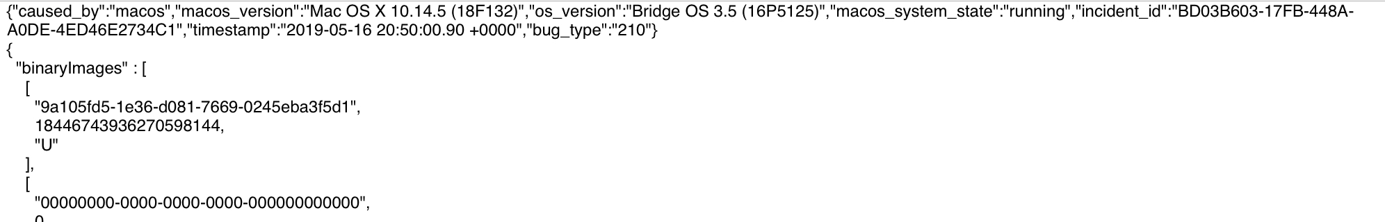

{"caused_by":"bridgeos","macos_version":"Mac OS X 10.14.5 (18F96h)","os_version":"Bridge OS 3.5 (16P55095c)","macos_system_state":"running","incident_id":"533FB55E-9BD1-46B5-A665-207C6C40163F","timestamp":"2019-04-05 14:31:37.07 +0000","bug_type":"210"}

{"caused_by":"bridgeos","macos_version":"Mac OS X 10.14.5 (18F108f)","os_version":"Bridge OS 3.5 (16P55107b)","macos_system_state":"running","incident_id":"D34B7254-2A79-4D31-B3DF-FCF8A22112A6","timestamp":"2019-04-14 01:13:52.39 +0000","bug_type":"210"}

Guess what? No solve. Here it is AGAIN crashing with the SAME issue. I mean, it's bridgeOS... it's not my userspace software. Anyway. Here is error.
{"caused_by":"bridgeos","macos_version":"Mac OS X 10.14.4 (18E227)","os_version":"Bridge OS 3.5 (16P55107b)","macos_system_state":"running","incident_id" ...

{"caused_by":"bridgeos","macos_version":"Mac OS X 10.14.5 (18F132)","os_version":"Bridge OS 3.5 (16P5125)","macos_system_state":"running","incident_id":"DEAE6542-134F-4BB7-BA51-887C6882A67B","timestamp":"2019-05-16 01:33:22.80 +0000","bug_type":"210"}
