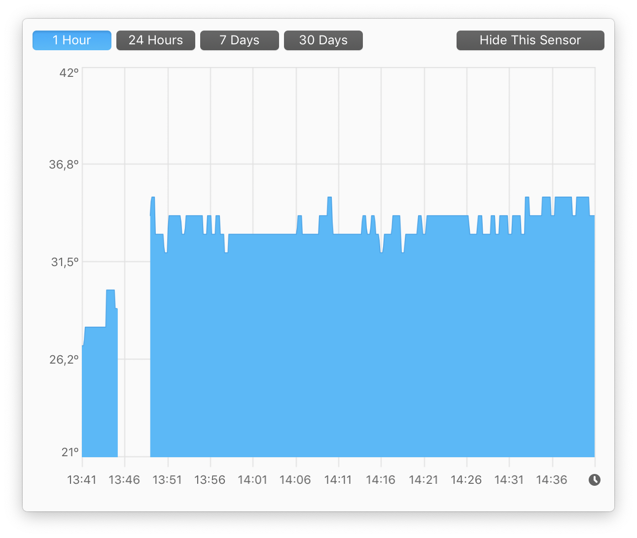

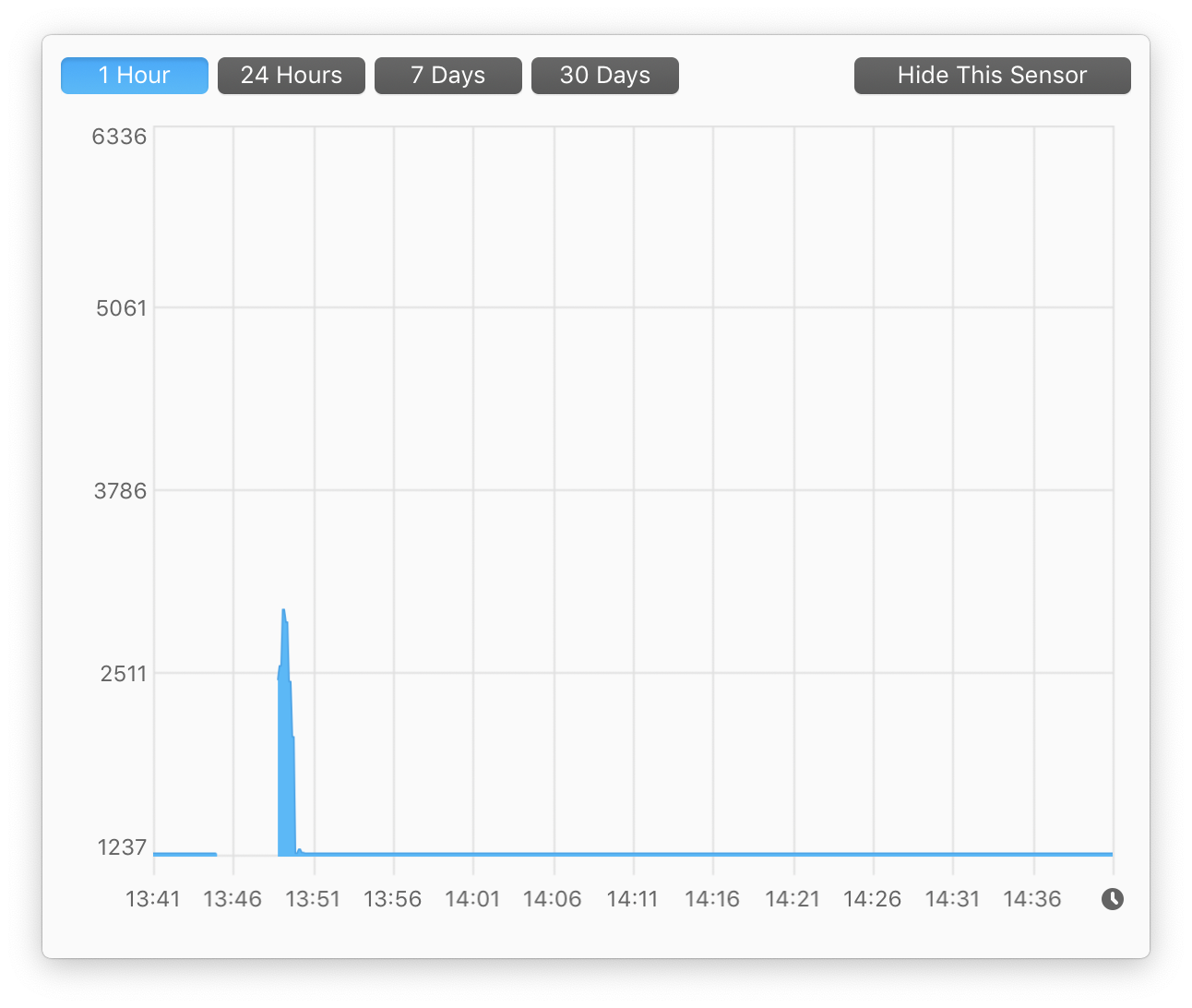

After upgrading to 10.14.1 yesterday, I just had a reboot. I'm not sure if it was a kernel panic, because there was no kernel panic screen, no crash report, the screen just turned black and it restarted. The last one I encountered was approx. 2 weeks ago. I'm also using BTT. There are some entries in /Library/Logs/DiagnosticReports from the time around the reboot, but it is mostly gibberish. I also checked sensor data from iStat menus. They all stopped gathering data 5 minutes before the reboot, 1st one is CPU temp, 2nd is SSD temp, 3rd one is fan speed. All sensor data shows this 5 minute gap. I always put the machine to sleep by closing the lid, I don't know if it has anything to do with this. I don't use any peripherals either. (I'm using the '13 base model with touchbar from 2018)
