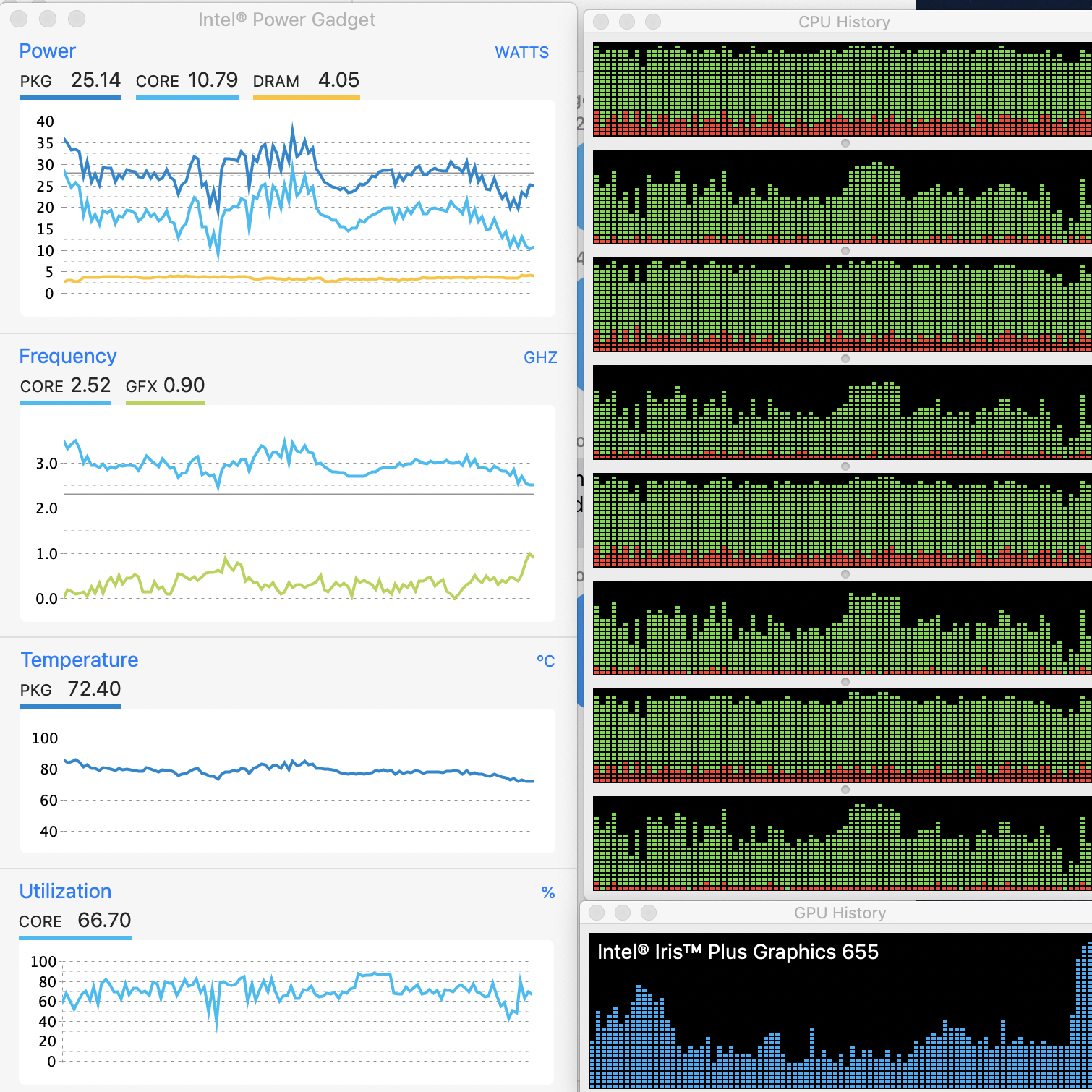

To illustrate my point above this is just playing a 4k60hz HDR video from YouTube (FireFox browser) on an external 4k60hz HDR display from my MacBook via USB cable (no hub).
CPU usage is so high because the video was encoded with VP9 (if it was HEVC I doubt it would have played very smooth). Since the video was buffering the CPU usage and temps were dropping off toward the end. Prior to that CPU temps were around 90c with the fans at max. And it was throttling on power consumption limits. Just to play a video....Maintained a nice all core turbo the entire time though....

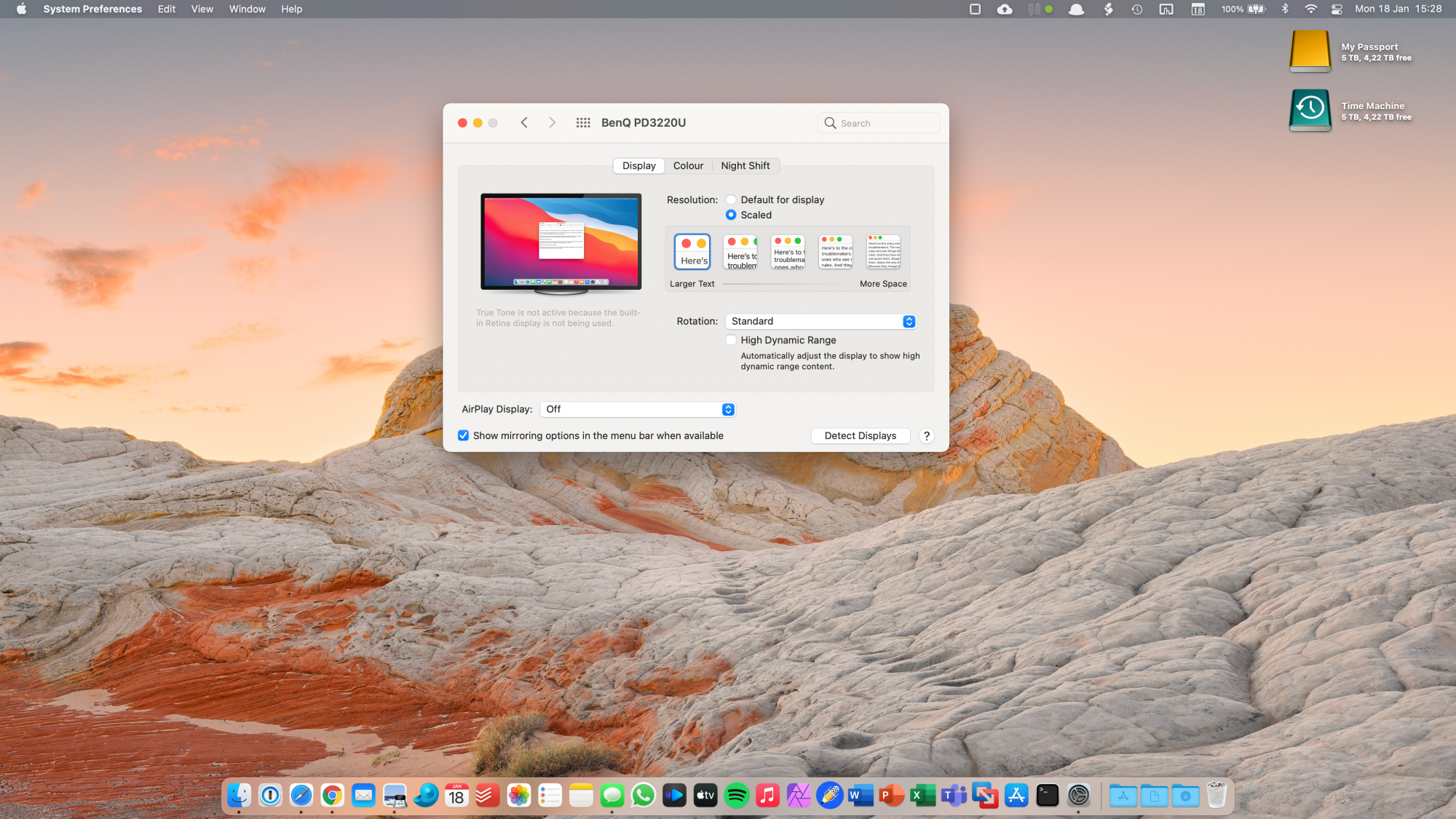

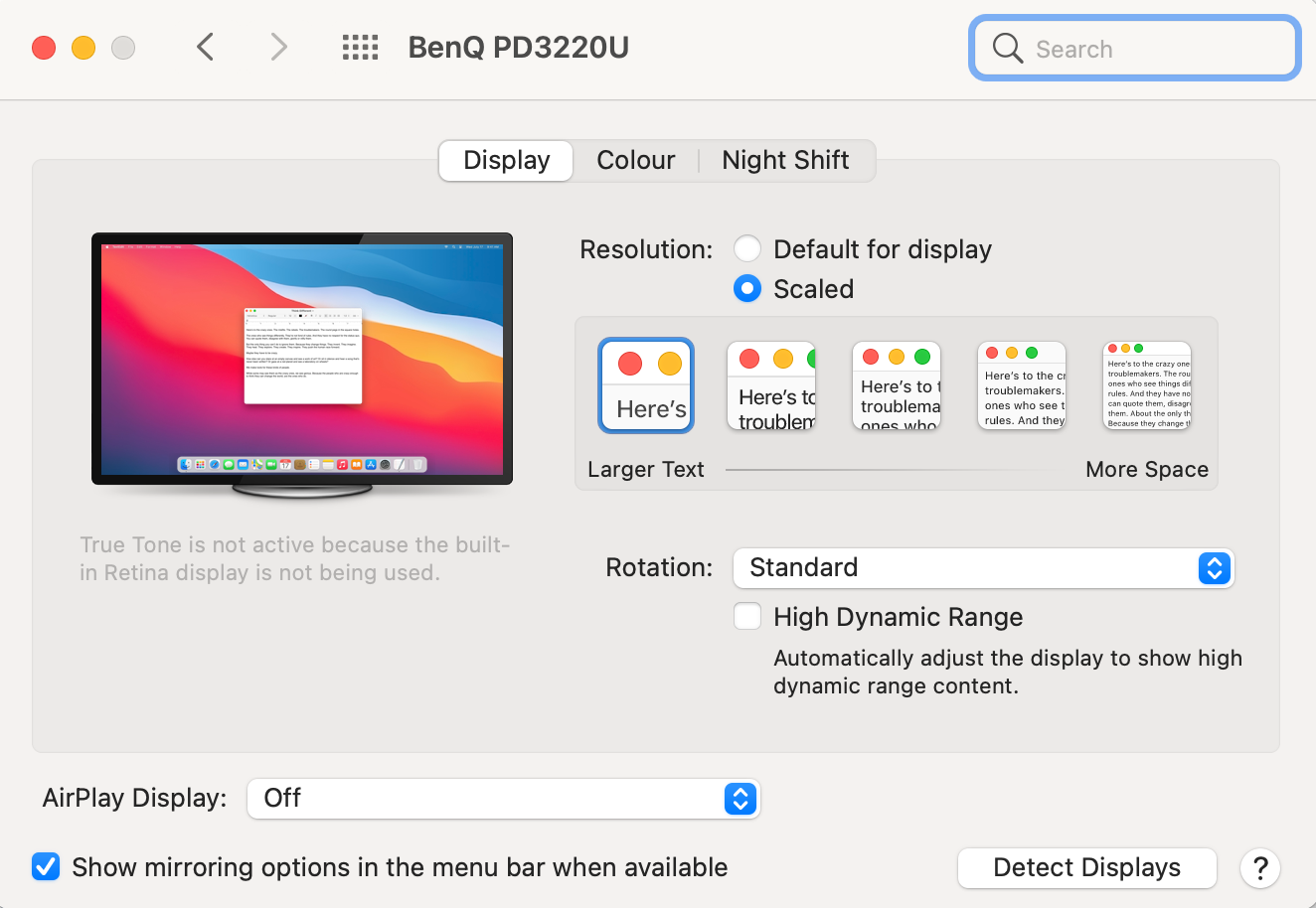

I could say that I "partially" solved the issue, let me explain. I didn't resell my 2018 MBP, it is still the machine I'm typing on at the moment (or more precisely, I have it connected to another monitor). Indeed, I even bought, in addition to the first BenQ EW3270, another monitor which is more precise in the colour fidelity (and somehow more demanding, I notice a very slight performance degradation compared to the EW): it is the BenQ PD3220U, also 4K and connected via Thunderbolt 3 to my MBP. I am really happy with those two monitors but don't use them at the same time, I have them in different places.
Coming back to the laptop issue, I can say that it is 95% perfect. As it was recommended by some in this thread, I'm using a scaled resolution but a "perfect" scaled one. It is actually the first one "looks like 1920 x 1080". It is important to avoid the 3 options in the middle as those are not perfect scaled and may degrade performance. I was not used to the bigger text first but it is really comfortable and not that big after all, I can still see a lot of content on my screen:
Performance has been stable with Catalina and now Big Sur with no issue for day-to-day use: browsing, email, messaging, light office tasks (Excel, Word, PowerPoint). Last year, I even managed to work on a FCPX video and an Affinity Design catalog. Interface was mostly smooth but the laptop can get quite noisy, especially with the open lid and the webcam turned on (like during a MS Teams call, very frequent with the current pandemic). Another issue that I sometimes encountered (on my uni platform, Moodle) is scaling: text can be really big on the screen when accessing a webpage, almost like I accidentally clicked on the zoom button of Safari (200%). I have to scale it back every time, that is cumbersome.
However, when taking my laptop with me, I am always surprised by how small it is 😂 I guess that is part of the comfort you gain from an external screen. I was planning to acquire the new M1 Mac Mini to test the new chip but also to run it as a home server and to get a proper desktop. I will make a post if that happens but for now, it is fine. What I wish was maybe more GPU power (to handle things like video editing), I guess I'll be satisfied with the next M1 14/16" MBP! My 2018 MBP is thus still a capable machine!

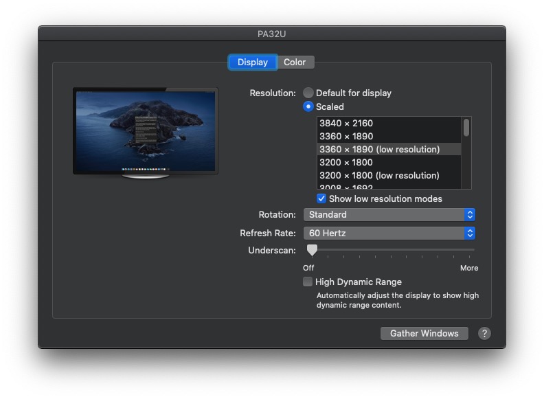

Experiencing lag, slowing down mac when connecting an external monitor. We have had this experience with several Macs, even a MacPro 2020 with everything maxed out.
  • Do the following to resolve this:
  • Go to display settings
  • Switch "Default for Display" on your external monitor display settings
  • Hold OPTION and click Scaled
  • Check "show Low-Resolution modes"
  • Select desired resolution with (low resolution) attached to it
  • Mac Speed Normal!
Enjoy!
Youtube Video:
But you loose cca 2M pixels and will looks blurry.
Yes MacOS "render" 6M pixels instead 24M (with 3360x1890 - and then downscaled to 3860x2160..) So there is four times less load for cpu and gpu...
I see nothing blurry at 3000+ pixel.. and have a fast computer. ^_^
attached my "Low REs" setting screenshot ... no clue if it gets compressed here.
Tested.. gets downscaled to 2000px and compressed. But still nothing blurry ;-)
Original is 3360x1890 and is crisp
