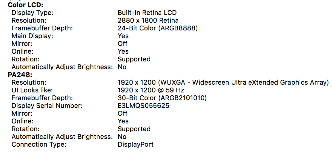

With the updated TB3 controller in the new MBP, It seems that the way both DisplayPort as well as HDMI is negotiated with external displays has been altered causing the 2018 MBP to be incompatible with some displays.
I have an ASUS PA248Q that I have attempted to connect to my 2018 MBP with various quality DisplayPort as well as HDMI cables. The initial indicator is a color fringing that appears around the text in OS elements but upon closer inspection, the actual signal is of much lower quality than it should be. I ran a direct comparison from a 2015 MBP and my 2018 MBP and the newer machines output is nearly half the quality of that of the older machine. Something has been changed with how the new TB3 ports negotiate this signal and it seems to have broken the compatibility to some external displays.
I've been through Apple Support and the Genius Bar with this as well as a bunch of different connection methods and cables. The color fringing can be "fixed" by de-selecting "Use LCD font smoothing" in General Preferences but the very noticeable change in the visual quality of output has still be left unaddressed.
Is anyone else experiencing issues like this?

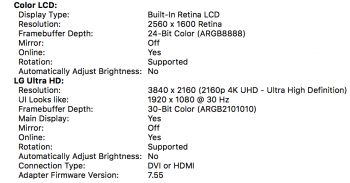

My old 2013 allowed my 4k monitor to run with HDR enabled. My new 2018 doesn't. Something is different. I did find that using a USB-C to HDMI cable was the best solution, rather than going via a dock or dongle.
I tried USB-C to HDMI as well as USB-C to DisplayPort as well as Thunderbolt to a CalDigit TS3 Plus dock that then outputs to a monitor via DisplayPort all with the exact same results.
Something has definitely been changed and broken what was working. My concern with the "Andrew Daugherity fix" is that it seems to fix an operating system issue where the OS and paired drivers are not playing nice with specific displays. But my display is working fine with a 2015 MBP running Sierra and shows up properly in System Report on both systems. Would it show 30-bit color if HighSierra was mistaking my display for a tv and outputting? Does a mac even support or output 10-bit YCbCr color? Also, others that are using this fix report an extra line in their System Report that lists the monitor showing as a TV.

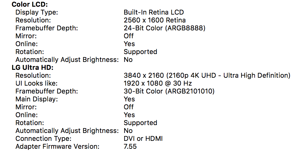

This is mine, which doesn't even show the monitor at 60Hz now. I have no idea what is going on with High Sierra or why it's being such a dick, but I've given up with it for now.
I cannot show 60Hz, I cannot show HDR. I don't even know where to start to fix it.
