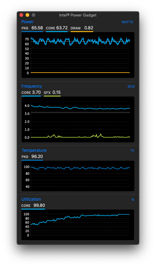

Update. I may have led you all very astray with those obscenely low temps. The app I was monitoring temps with, Fanny, was giving me only the CPU proximity temp, not the core/die temps...
So, with that being said, at load this baby is getting up to a peak of 100C, though it floats around 92-96 at load. This is using both Mac Fan control and Intel Power Gadget

My mini is setup and I'm doing an encode with handbrake, H.265 10bit. I have the 3.2ghz i7.
I'm also streaming a 4k movie via plex to 2 iPhones and a previous gen MacBook Air.
It shows the CPU is running at 3.6ghz with a temp of 97c. Temp is bouncing between 94-99. Clock speed goes from 3.5 to 3.7
The mini is a little warm to the touch but not even remotely close to hot. The air coming out of it is warm.

I can't complain. The cooling system in the 2018 Mini lets the CPU run at max temperature and TDP continuously:
3.7GHz with all threads loaded is 100MHz faster than the 2018 i9 MBP after the latest thermal throttling fix. My 2018 i7 Mini runs quieter fully loaded than my 2014 i7 Mini did when fully loaded. And it has 3x as many threads.

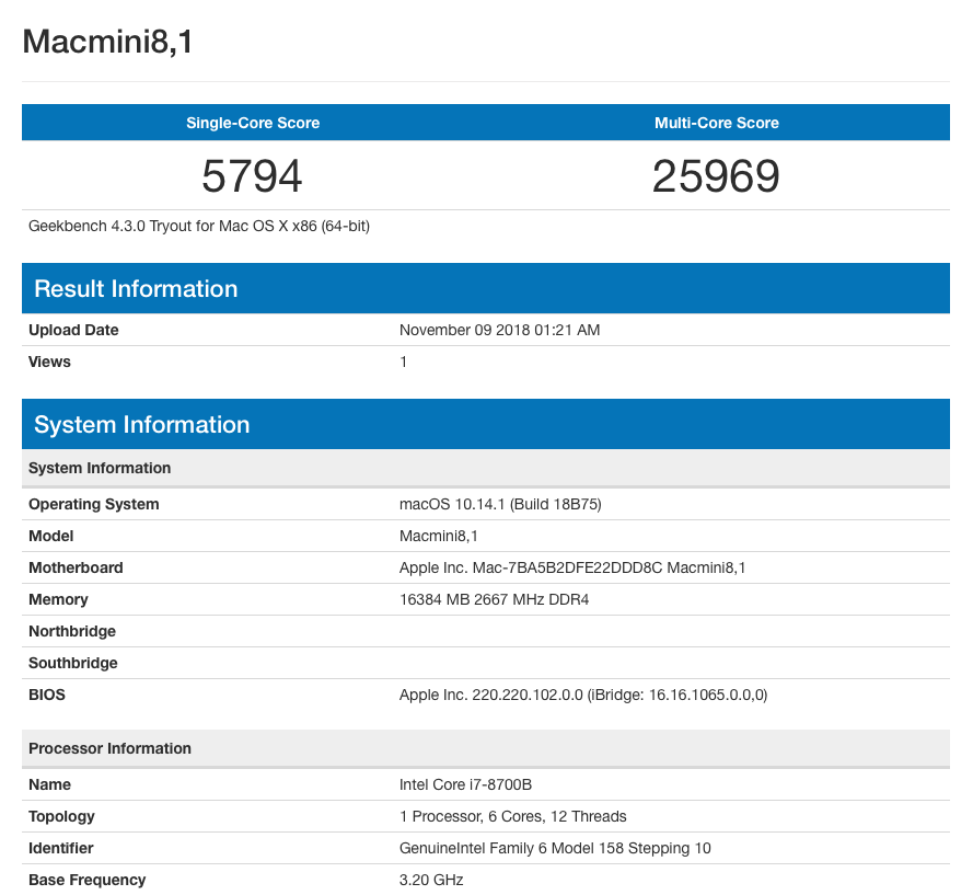

[doublepost=1541779296][/doublepost]Also, geeze, synthetic benchmark caveats aside, this little thing is a beast:
