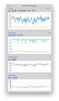

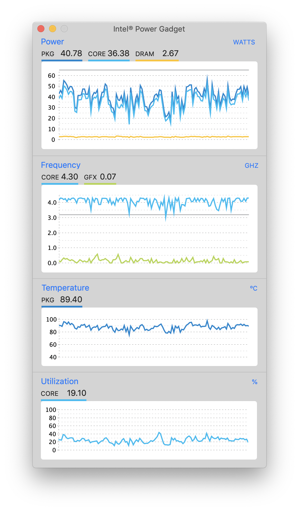

Does this look normal to you guys? I got the new 3.2ghz i7.

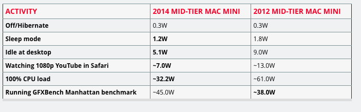

This is the quality of power consumption eval I'm looking for in a review. This was from 2014 review here:
https://arstechnica.com/gadgets/201...e-were-hoping-for-the-2014-mac-mini-reviewed/
Waiting for Ars Technica and AnandTech this time in 2018!
According to everymac.com, the 2014 Mini was released on 10/16/18 and the Ars review was dated 11/6 so it might be another 10 days but c'est la vie!
